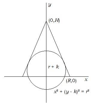

choose the diameter of a sphere so that when it is inserted into a cope of form conic (depth H and RADIUS R) fill of water, spilling as much as possible of liquid when the sphere rests is on the walls of cope. ( volume of a segment spherical of radius "r" y height "h' es: V = pih2{r- ( h ))
Answer
r= HRL/(L-R)(L+2R)
Re: max and min 276

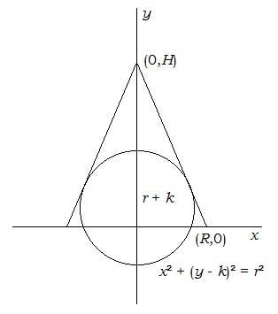

I would draw a diagram as follows:
From this you can get the constraint. For the objective function, we need the volume of a spherical cap:
$$V=\frac{\pi h}{6}\left(3a^2+h^2 \right)$$
$a$ will be the positive $x$-intercept of the circle and $h=r+k$.
Can you proceed?

No...$h=r+k$, you need to find $a$ as I described (the positive $x$-intercept of the circle), and you need to find the constraint. The most straightforward way I can think of is to use the fact that a radius of the circle drawn to the point of tangency of the line segment from $(0,H)$ to $(R,0)$ is perpendicular to this segment, and so the formula for the perpendicular or shortest distance between a point and a ine may be used to obtain the value of $k$ in terms of $R$, $H$ and $r$. Another method which yields the same result, but requires more algebra is to equate the equation of the line to the circle and require the discriminant of the resulting quadratic to be zero.
The formula for the distance $d$ between a point $\left(x_0,y_0 \right)$ and a line $y=mx+b$ is:
$$d=\frac{\left|mx_0+b-y_0 \right|}{\sqrt{m^2+1}}$$
We know in this case that $d=r$. Can you identify $m$ and $b$?

Re: max and min 276
No, what you want to do is:
$$r=\frac{\left|-\frac{H}{R}\cdot0+H-k \right|}{\sqrt{\left(-\frac{H}{R} \right)^2+1}}$$
Now solve this for $k$ (observe that $H>k$) and substitute into the objective function. And you STILL need to find the positive $x$-intercept of the circle to use for $a$. Recall, your objective function is:
and $h=r+k$. This is why you need $k$ and $a$.

If you mean:
k = (HR - Lr)/R
then that is correct. However, $a$ is the positive $x$-intercept of the circle:
$$x^2+(y-k)^2=r^2$$
Hence:
$$a=\sqrt{r^2-k^2}$$
Now, put the value of $k$ in there...and try to simplify.
Now, after you do this, what do you suppose you should do with these values?
