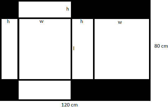

My question is that I have to find the dimensions of a rectangular prism (cuboid), where none of the faces are square that will maximise its volume. The sheet metal I have to build it from is 120 cm by 80 cm. I don't even know where to start, I can do it if I'm given a height, width or length but nothing is given.

Is the provided template something like:
If so, we would have for instance $l + 2h = 80\text{ cm}$...

Is the provided template something like:If so, we would have for instance $l + 2h = 80\text{ cm}$...
Yes that's what the template looks like, we have done another one where the length was twice the width but not one with so many variables

2h + 2w = 120 cm

Good! (Nod)
So we have:
$$\begin{cases}l+2h=80 \\ 2h+2w=120\end{cases}
\Rightarrow \begin{cases}l=80-2h \\ w=60-h\end{cases}
And we want to optimize $V=l\times w\times h = (80-2h)(60-h)h$.
Looks like we can take the derivative and set it equal to zero, can't we?

$$f(h)=(80-2h)(60-h)h=2h^3-200h^2+4800h$$
$$f'(h)=6h^2-400h+4800=0\implies h=\dfrac{100\pm20\sqrt7}{3}$$
$$\Rightarrow h=\dfrac{100-20\sqrt7}{3}\approx15.7$$
$$f''(h)=12h-400,\quad f''(15.7)<0$$
so we have found a maximum ($f(h)$ is concave down at $f(15.7)$).
