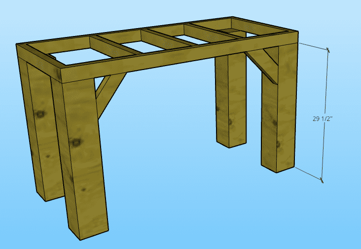

I have a table and I am planning to put wheels on the four legs. How do I calculate the amount of weight the casters I buy need to hold, given the load
Currently I have 6 casters with a 90lb capacity, but I need this “table” (closest description to the shape) to hold over 500lbs. If I double up the wheels on the “legs” will that increase the weight capacity?
Can you post a sketch of the table? (Use the "Attach files" link below the Edit window)
What is the 500 pound load? What are the consequences if the table fails and the load falls?
Remember, three points determine the "plane" of the table.
The load is about 3 people (it's the frame for a prop), if it fails we fall :-)
I suppose I am assuming that 6x6s are sufficient to hold us up?
There is also a plywood top I didn't bother CADing.
Hmm, that's not good...
Does this get wheeled around as part of the scenes in the play, or only to move it between scenes? Is it moved with people on it?
Ideally it would be moved with people standing on it, during the scene. We're not too concerned with how we'll push it since worse case someone gets off.
How do you plan on installing six caster wheels on four legs?
How flat and hard and free of steps and gaps the rolling surface is?
Small wheels easily catch on those surface irregularities.
Jumping backwards from 30 inches high is not so easy: tipping over toward the back of the bodies is the worst situation, as someone’s head may hit the floor.
Is it feasible to spread the location of the casters toward a square footprint?
How do you know that the three people will not all stand in the same corner, above the same leg?
Maybe you need to look at industrial strength casters that will be capable of supporting 500 lbs each.
https://www.ebay.com.au/itm/175035922479
The surface is likely carpet and has no steps. The whole "table" is only 5'x2' so it's unlikely to be too unbalanced because of space constraints of where people can stand, but I see your point. People would likely sit and slide off, so I was hoping the weight of the wood would counteract most of that imbalance, especially if I get casters with brakes.
I didn't really think through how I would fit six casters, but they were small so I kinda figured I could fit 2 side by side on two of the 6x6 posts.
The posts would ideally stay where the are now, but I could add a horizontal brace at floor level in the short direction if you think that would help.

Quietrabbit said:
Is the suggestion that I need 500lb each?
That is the sort of reality I would expect. When you push high up on a structure, that is travelling over, say a carpet that offers resistance to wheel movement, the supported weight is transferred to the front wheels.
Casters for heavier loads also have a greater diameter and floor contact patch, that will roll better over carpet. 4x industrial casters for $50 is a simple solution.
It is called a safety factor. Especially when human safety is involved, the factor should be generous. Three times the maximum load expected would be reasonable.
Three 200 pound people, plus 200 pounds for the wooden table, gives 800 pounds total. Factor of three for safety gives 2400 pounds, or 600 pounds per leg.
The people better not be standing when you try to push that table across carpet! Just trying to start that thing moving with little castors on it will cause a big jerking motion which would easily topple them off. Even when sitting, it will be an uncomfortable ride. At least when (not if) they fall off, it will be onto a carpeted surface and not concrete...
There are a few issues that you haven't included. You may have thought about them but they should be included in this discussion as it needs to be a 'complete engineered system'. What you have described is a bit along the lines of a skateboard but worse because there are more than just one passenger. Frankly, the load bearing qualities of the wheels is way down the list of considerations - just use ridiculously big ones and you would have all the advantages that big car wheels have over 'mini' wheels on an uneven surface.
There is no safe way that this table could be moved about freely with three people standing on it. There should be a rail at the back (or even a U of three rails) to keep them from falling off. If one falls off then the other two could also be thrown off (Newton's Third law).
At least two of the casters should have brakes to keep the table still when passengers move about. The table should be moved about by an extra person, standing on the floor, with a rod (fixed at an appropriate height).
