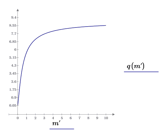

In a basic version of this problem there are two equations to work with. ##T_s## is the temperature of the surrounding environment (assumed to be a constant) ## T_i, T_o## are the mean inlet and outlet temperatures of the internal flow. ##P## is the perimeter of the pipe, ##L## its length and ##\bar{h}## the average convection coefficient over the length of the tube. ##c_p## is the specific heat of the fluid, and ##\dot m ## the mass flowrate. This analysis gives the following result:
$$ \frac{T_s - T_o}{T_s - T_i} = e^{ -\frac{PL\bar{h}}{c_p} \frac{1}{\dot m} } \tag{1} $$
And the heat rate(power) ##q## extract from the flow is given by:
$$ q = \dot m c_p ( T_i - T_o) \tag{2}$$
Assuming ##\dot m ## is what you are trying to manipulate to create the desired change, sub (1) into (2):
$$ q = \dot m c_p ( T_i - T_s ) \left( 1 - e^{-(PL\bar{h})/( c_p \dot m)} \right) $$
The basic shape of this function is the following:
Graph of q(m') against m': the curve rises steeply from about 0.05 at m' = 0, flattens, and levels off near 8.55 by m' = 10.
Depending on where you currently are on the curve (in your system), you may struggle to find performance change through the variation of ##\dot m ##(if that is what you are after).
