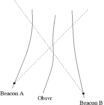

Is there any standard way for measuring the metric tensor. Does it require the a priori specification of a coordinate system relative to which we measure the components of the metric, or is there a way to measure the underlying geometric object?
Suggest two options: Riemann normal chart or Coll canonical chart
Hi Dale, good question, in fact I have long planned a BRS concerning a closely related question, "how can you measure the curvature tensor of our spacetime?" There are several papers in the gtr literature (try journals like Gen. Rel. Gravitation) on this, and some textbooks such as de Felice and Clarke, Relativity on Curved Manifolds, discuss it too.

The second thing which springs to mind is recent work by B. Coll and his students on providing a foundation for third generation satellite beaconing navigation systems, ones which will permit mapping of events in time and space to cm accuracy in the solar system, not just near the surface of the Earth. This is quite fascinating and deserves a BRS in itself. The basic idea is to use time signals sent regularly from a set of beacons to define a Coll canonical chart. For a two-dimensional locally flat Lorentzian manifold, in the simple case of two inertial (but not comoving) beacons, the line element can be written in the Coll chart as
[tex] ds^2 = -k_1 \, k_2 \, du^1 \, du^2[/tex]
where [itex]k_1, \, k_2[/tex] are the frequency shift factors for signals from the two beacons, as received by an inertial observer (not comoving with either beacon, in general) whom we can call "the static observer". We can boost the frame with a boost parameter depending on u^1, u^2, and then we see that (if our observer is <i>between</i> the two beacons) we get the same metric: not only does the product k_1 \, k_2 not depend on which inertial observer we use, <i>it doesn't even depend on whether we use an inertial observer at all!</i><br /> <br /> For those of you who use Maxima, here is a Ctensor file you can run as a batch file under wxmaxima:<br /> <div class="bbCodeBlock bbCodeBlock--screenLimited bbCodeBlock--code"> <div class="bbCodeBlock-title"> <i class="fa--xf fal fa-code "><svg xmlns="http://www.w3.org/2000/svg" role="img" aria-hidden="true" ><use href="/data/local/icons/light.svg?v=1790085123#code"></use></svg></i> Code: </div> <div class="bbCodeBlock-content" dir="ltr"> <pre class="bbCodeCode" dir="ltr" data-xf-init="code-block" data-lang=""><code>/* E11 manifold; Coll canonical normal chart for two inertial beacons u^1 = time signal from 1st beacon k_1 = frequency shift of 1st time signal msrd by inertial observer u^2 = time signal from 2nd beacon k_2 = frequency shift of 2nd time signal msrd by inertial observer v = velocity of obsvr relative inertial obsvr comoving with both becaons (a function of u^1, u^2) Form of metric is entirely independent of v */ load(ctensor); cframe_flag: true; ratchristof: true; ctrgsimp: true; /* define the dimension */ dim: 2; /* list the coordinates */ ct_coords: [u1,u2]; /* define variables */ constant(k1,k2); depends(v,[u1,u2]); /* define background metric */ lfg: ident(2); lfg[1,1]: -1; /* define the coframe */ fri: zeromatrix(2,2); fri[1,1]: -sqrt(1-v)/sqrt(1+v)*k1/2; fri[1,2]: -sqrt(1+v)/sqrt(1-v)*k2/2; fri[2,1]: -sqrt(1-v)/sqrt(1+v)*k1/2; fri[2,2]: sqrt(1+v)/sqrt(1-v)*k2/2; /* setup the spacetime definition */ cmetric(); /* display matrix whose rows give coframe covectors */ fri; /* compute a matrix whose rows give frame vectors */ fr; /* metric tensor g_(ab) */ lg; /* compute g^(ab) */ ug: invert(lg); christof(false); /* Compute fully covariant Riemann components R_(mijk) = riem[i,k,j,m] */ lriemann(true); cgeodesic(true);</code></pre> </div> </div><br /> Here, u^1 has the intuitive meaning that an observer an an event with coordinate u^1 = 123 has just received a time signal reading "I am beacon 1 and my time is 123 seconds", and this signal has been frequency shifted by the amount [itex]k_1[/itex] (static observer) or [itex]k_1 \, \frac{\sqrt{1+v}}{\sqrt{1-v}}[/tex] (arbitrary observer to right of first beacon). Combining the observed values at event p of [itex]u^1, \, u^2, \, k_1, \, k_2[/tex], our arbitrarily moving observer at p knows both the Coll chart label of p and the line element near p. So in the special case of<br /> <ul> <li data-xf-list-type="ul"> two dimensional <i>flat</i> spacetime</li> <li data-xf-list-type="ul"> two <i>inertial</i> (but not neccessarily comoving) beacons with reliable clocks</li> </ul>this spacetime charting scheme is practical and simple. But there is a hint of trouble ahead: we need to assume our arbitrarily moving observer has a world line in the region between the world lines of the two beacons! (Only then does the Doppler shift due to the boost we introduced above cancel when take the product of the observed frequency shifts of the two time signals.)<br /> <br /> More generally, one can consider an arbitrarily moving pair of beacons. For curved manifolds things are more complicated. And for higher dimensions things are still more complicated--- at least if you seek exact results.<br /> <br /> Curiously, what has been lacking to date is a suitable <i>approximation scheme</i>, which is clearly what one really wants. For one thing, we might want to use more beacons than the dimension of spacetime, as a check.<br /> <br /> But in any case, the point is that, following Coll's approach, we should try to work out a scheme in which we simultaneously construct a chart and its metric tensor.<br /> <br /> For me, one of the fascinating aspects of this work is that it hearkens back to the roots of my Ph.D. thesis, even the roots of mathematics itself. That is, the theory of Penrose tilings depends heavily upon simple continued fractions, whose theory was worked out by Theaetetus, a brilliant Athenian teenager who had been hired by his native city state to concoct an improved calendrical system. Theaetetus came up with a simple general method for finding the "most efficient" rational approximations to any real number. That is, we want to find an approximation which uses small integer denominators but which is also very accurate. Then one can use what Gauss later called "mod n" to work out a calendar with appropriate periodicities, such that the best date for the harvest won't "migrate" quickly wrt the calendrical dates, which was a serious problem with earlier systems. This achievement was the start of Greek mathematics; and also the start of the theory of algorithms (the idea upon which Theaetetus founded the theory of simple continued fractions is also the idea behind the "euclidean" algorithm). Had Theaetetus lived longer, Greek mathematics might well not have become "stuck" on using purely "euclidean" geometrical methods.<br /> <br /> Anyway, one of the huge problems bedeviling both calendars and global mapping of the Earth is due to topology: the international date line continues to confuse modern historians writing about say the Gulf of Tonkin incident, who in principle need to figure out, with each document they examine, whether the times mentioned refer to Washington D.C. time and date, Gulf of Tonkin time and date, or (as is often the case) reflect confusion on the part of intelligence analysts and White House personnel about such time/space charting issues.<br /> <br /> At one point I even started to draft an expository paper with the provacative title "Is Bartolome Coll the new Copernicus?", which I think really does capture the fundamental nature of this problem and its remarkable place in intellectual history. The point of the title is that the Coll chart (and related schemes previously suggested by several other researchers) offers a completely novel approach which promises to completely evade topological problems, and which also fully dethrones accidental features of one small solar system from timekeeping and location charting. At the expense of introducing accidental features due to which region--- defined by the world lines of the beacons--- our observer lies in. But if our beacons are distant pulsars, and we are only trying to navigate around our dinky little solar system, this is not likely to become problematic! <br /> <br /> However, such a solution would only become practical when some new Riemann concocts a suitable approximation scheme. I haven't sufficient optimism to think about it, but maybe one of you will <img src="https://cdn.jsdelivr.net/joypixels/assets/8.0/png/unicode/64/1f609.png" class="smilie smilie--emoji" loading="lazy" width="64" height="64" alt=":wink:" title="Wink :wink:" data-smilie="2"data-shortname=":wink:" /><br /> <br /> Further reading:<br /> E. T. Bell, <i>Men of Mathematics</i>, Dover reprint, chapter 14.<br /> <br /> K. F. Gauss, <i>General Investigations of Curved Surfaces</i>, Dover reprint of Princeton translation, 1902, originally given as a talk in <i>Latin</i> (not German!) in 1827 at the scientific society of Goettingen, but not published for another 25+ years.<br /> <br /> Michael Spivak, <i>Comprehensive Introduction to Differential Geometry</i>, 2nd edition, Publish or Perish Press, 1979, Vol. II, chapters 3 &4. (Chapter 3 includes a proof of Diquet's formula and chapter 4 includes a translation of B. F. Riemann, "On the Hypotheses which Lie at the Foundations of Geometry", 1854, the famous lecture which so impressed Gauss, in which Riemann introduced the Riemann normal chart and Riemannian geometry.)<br /> <br /> <div class="bbCodeBlock bbCodeBlock--screenLimited bbCodeBlock--code"> <div class="bbCodeBlock-title"> <i class="fa--xf fal fa-code "><svg xmlns="http://www.w3.org/2000/svg" role="img" aria-hidden="true" ><use href="/data/local/icons/light.svg?v=1790085123#code"></use></svg></i> Code: </div> <div class="bbCodeBlock-content" dir="ltr"> <pre class="bbCodeCode" dir="ltr" data-xf-init="code-block" data-lang=""><code>arxiv.org/abs/gr-qc/0606044</code></pre> </div> </div>Relativistic Positioning Systems: The Emission Coordinates<br /> Bartolomé Coll and José MarÍa Pozo<br /> <br /> <div class="bbCodeBlock bbCodeBlock--screenLimited bbCodeBlock--code"> <div class="bbCodeBlock-title"> <i class="fa--xf fal fa-code "><svg xmlns="http://www.w3.org/2000/svg" role="img" aria-hidden="true" ><use href="/data/local/icons/light.svg?v=1790085123#code"></use></svg></i> Code: </div> <div class="bbCodeBlock-content" dir="ltr"> <pre class="bbCodeCode" dir="ltr" data-xf-init="code-block" data-lang=""><code>arxiv.org/abs/0905.3798</code></pre> </div> </div>Gravimetry, Relativity, and the Global Navigation Satellite Systems<br /> Albert Tarantola, Ludek Klimes, Jose Maria Pozo, and Bartolome Coll<br /> <br /> I know, I haven't tried to answer the question--- let me know whether either Riemann normal chart or Coll canonical chart sound like what you are looking for, and I'll try to say more.<br /> <br /> Figures (left to right):<br /> <ul> <li data-xf-list-type="ul"> sketch of length along a curve, up to second order in distance from P, according to the Riemann normal chart centered at P</li> <li data-xf-list-type="ul"> sketch of construction of Coll canonical chart and spacetime charting, for a Lorentzian two-manifold</li> </ul>[/itex][/itex][/itex]
