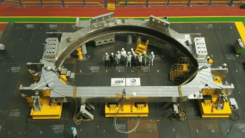

Is there a prediction/paper/etc. about the mechanical loads that will be reacted onto ITER's magnetic coils?
The reason I ask is a simple calculation. My understanding of the numerical figures on ITER are that it is intended to contain;
density ~10^20
temperature ~20keV
I think that means a specific energy density of; 2e4 * 1e20 * 1.6e-19 = 320kJ/m^3
So a pressure of 320kPa.
If there is 850m^2 surface area (from https://www.sciencedirect.com/science/article/pii/S0920379610004060) then that's a total mechanical load of 272MPa (~27 atmospheres of pressure).
That is an equivalent load of 27MN on the coils on 18 toroidal coils, or 1.5MN each. That's like a 150,000 tonne load inside each coil.
I am trying to visualise hanging one of these coils and putting 5,000 fully loaded trucks inside one!
What I am thinking wrongly? Or is this right and these are mechanically very strong coils?

The surface area is a torus, if you just multiply pressure by surface area you are double-counting forces that cancel each other.
Pressure is not the same as plasma energy per volume. ITER aims for 260 kPa pressure.
Even with your numbers: 1.5 MN corresponds to the gravitational force of 150 tonnes, not 150,000. As mentioned already forces on the magnets from the magnets are much more important.

Sorry, I got that calculation wrong there anyway. Taking that 260kPa figure, that is 260kN/m^2. There are 850m^2. So that should be 220MN on the equipment generating the forces to stop this gas expanding. Is this mistaken in some way?

Regarding the stresses imposed on the coil, it'd be like pressure in a pipe, ie evenly imposed radially on the coil, ie the coil would have to hold this load in tension, which is not so bad. Making a pipe to hold a fluid at 2.6Bar is relatively trivial.

Ahem electrical guy here!
Re forces, I would have to say they are imparted on the conductors themselves.
From ITER site:
"ITER uses high-performance, internally cooled superconductors called "cable-in-conduit conductors," in which bundled superconducting strands—mixed with copper—are cabled together and contained in a structural steel jacket."
The thing is an absolute monster!
