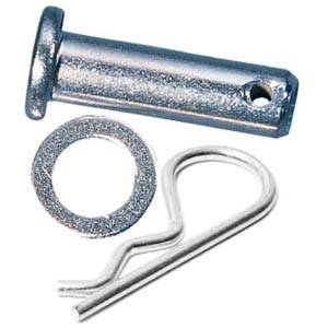

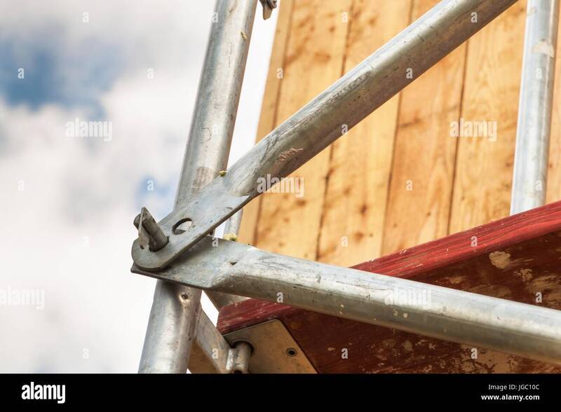

Wouldn't a clevis pin [and maybe washers] better suit your application?
Photo of a metal clevis pin with a flat head and a drilled cross hole near the tip, a flat washer, and a bent wire R-clip on a white background.
Close-up of galvanised steel scaffolding joint: a steel tube and bracket fixed by a pin through a plate, with a wooden plank and cladding behind and a cloudy sky.
