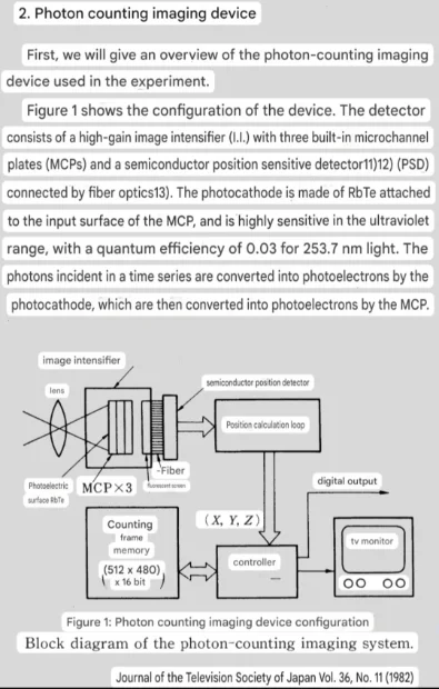

What are some of the examples of sensors with an extremely small dark current? Image intensifiers? Both Hamamatsu's slit experiment and night vision devices used image intensifiers. The image below shows the Hamamatsu setup of the slit experiment. It is originally in Japanese.

The spots you see are due to the phosphors on the screen being hit by (fast enough) electrons. Those electrons can be due to the wanted photons hitting the first part of the amplification chain. But those electrons need to be accelerated so that they can actually excite a phosphor. To make the sensor sensitive enough to register a photon you have to give it sufficient gain (accelerate it) and this will always register other electrons which are thermally generated in the device. A basic photomultiplier will always be subject to some thermal noise and to use it at maximum sensitivity (lowest density of incident photons) it will also register the internally generated electrons. SO the screen operates as electrons hit it but not all those electrons are wanted. There is no way of knowing when a flash is wanted or just noise.
That's a basic part of information theory; noise is always with us. You can minimise noise by using very low currents and by drastically cooling the sensor. Observing (well, actually sensing) a very distant astronomical object, telescopes basically analyse the outputs of all the sensor elements and decide whether or not the signal they get from an object is significantly bigger (more photons) than the surrounding space. (Which flashes are significant and which ones are not.) Your eyes are 'marginal' in this respect but they had no evolutionary need for that level of sophistication. Nocturnal animals can have better low light performance but they can have problems in bright sunlight.

Yes, and the watch my parents bought me when I was six is a mechanical watch, same as a top of the line Rolex. Slightly different engineering quality and precision, though, and slightly different price.
You need a sensor that has a low enough dark current that 20 photons/second (or whatever) stands out clearly. And you need it to have a high quantum efficiency so that you get a spot every time there's a photon, or photon doublers, beam splitters and coincidence counters. You probably need the whole thing mounted on an optical table, especially if you're coincidence counting. I have no doubt that you can buy this stuff, but you'll have to look at individual device performance and work out what level of performance you can tolerate.
It's been years since I had anything to do with optical experiments, but I can easily imagine spending four or five digits of pounds on this and still not having something good enough to do what you want.
You really need to think about what rate of photons you're going to produce and do a lot of maths and shopping around for equipment. I'd also strongly suggest finding a local optics lab and asking them for advice. There are almost certainly a lot of noise sources I'm not familiar with when you try photon counting.
Also, think about this: if this experiment was in reach of a dedicated hobbyist, do you really believe YouTube would not be knee-deep in videos of people doing it in their garages?
By all means spec out the experiment, but you will need to do a lot of careful choosing of specific components based on their data sheets and a lot of careful maths, and I strongly suspect the price tag will have more digits than you expect. And you need the risk tolerance to swallow that tag and accept you may not make it work.
