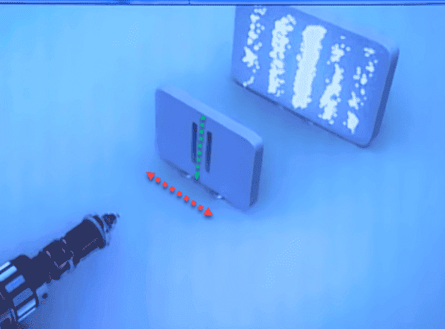

Please have a look at this piece from the video: https://imagizer.imageshack.com/img924/5033/e0ADHd.gif
At a time only single electron is shot at the slit and I think the electron gun should be stationary and must have a extremely nozzle like opening. Is the gun aimed at right slit or left slit, or the at the middle point of the slits?
If the beam of electrons had no uncertainty in the lateral direction, then there would be no double slit experiment. Every electron would do the same thing: go through the first slit, go through the second slit or impact the intervening barrier.
In order to have the double slit experiment, the slits must be close together, narrow and the lateral uncertainty in the electron beam must span the two slits. To get a perfect pattern, the beam ought to be centred right between the slits, so that both slits are equally "probable".
Thank you! In the picture below red arrow represents lateral direction and the green arrow represents ideal area where the beam should be aimed.
