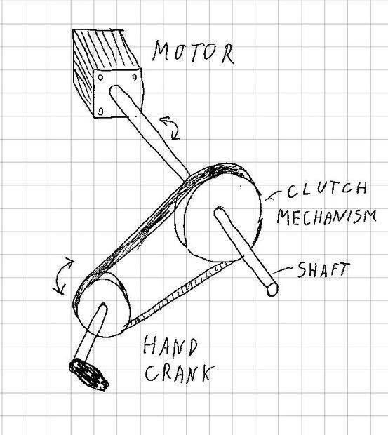

I want a mechanism with the "output shaft" being able to freewheel as long as you are not turning a hand crank, but when turning hand crank in either direction the input and output should be locked together.
I have an application in mind with a hand crank mechanism that will usually not be engaged to a trugh shaft so it can freewheel, but as soon as you start turning the hand crank in either direction it should engage with the shaft. And i want it to be silent (no mechanical ratchets) and with minimal slop between when you start to turn the crank and when it engages the shaft.
Is this possible?
The first thing i was thinking was to use two sprag clutches around the driven axle mounted in opposite directions with the outside race connected to the hand crank. And then some kind of friction mechanism that engages and disengages the springs in the sprag clutch when you start to turn the hand crank by a few degrees (friction pushes the sprags out, and when they contact the axle they bind and that takes care of all the forces from there and when you let go on the hand crank wheel some spring mechanism gets it back to neutral position so the sprags no longer contacts the axle so it is freewheeling again). The key thing here is that it should work in both directions so just a normal sprag clutch mecanism will not work. And it should be able to turn the hand crank all the way around as many turns as you want.
The first obvious solution is to require the crank handle be pushed axially against a light spring to engage a clutch with the motor shaft. The turning of the crank would then rotate the motor. If the engagement was achieved with a pair of crown gears with a 20° contact angle, mounted co-axially face-to-face, then the crank would disengage automatically when the motor was powered.
A more complex way is used on the pull start of two stroke motors. That expanding clutch inside a cylinder can be altered to operate in both directions. The system relies on friction against the housing, and rotation of the "crank", to drive a pair of engagement dogs out against what is usually a plastic liner.
I don't want there to be any other movement to activate the clutch than the rotation of the crank. So the first suggestion does not work.
And i want it to work no matter how slow you turn the crank so a centrifugal clutch does not work either.

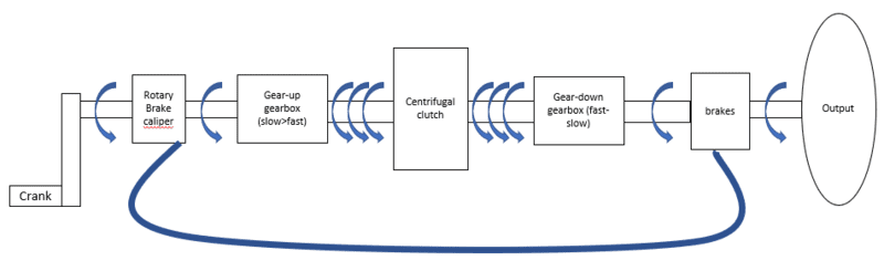

Further thoughts, prepare for terrible doodles!
This mechanism will require significant torque on the crank handle. How much will depend on the gear ratios and speeds, so it will need tuning to make it work properly, but I think it might be a system which will do what you want.
The way this would work, in my mind: (in all cases, input is on the left and output is on the right)
Crank - this is what you turn to engage the crank to the output, by spinning the centrifugal clutch up (which turns far faster than the crank so engages quickly.
Rotary brake caliper - this is designed so that if the torque between the input and output exceeds what you would expect for turning the centrifugal clutch up, the brakes are applied to a proportional amount. This links to the brakes by the output. This means that if the output is spinning faster or in the opposite direction to the centrifugal clutch, the brakes will be applied to slow it down or stop it. If it spinning slower, it should be calibrated such that this does not cause the brakes to apply. This will take some effort & tweaking! It may need a mechanism to mean that it only brakes if the output shaft is turning in the opposite direction or faster than the input shaft, and not engage if the output is turning slower than the input but in the same direction. It will need to base this off of a stationary outer casing.
Gear up gearbox - makes the input speed from the crank much higher, so the centrifugal clutch will engage promptly from even the slightest input.
Centrifugal clutch - this will allow the two halves to engage and release from one another as the crank is turned.
Gead down gearbox - brings the speed back to the amount you wanted.
Brakes - these slow down the output if it is not the same or slower than the crank, proportionally to the difference. If the crank is turned in the opposite direction, it gets maximum brakes.
Output - whatever it is you want turning & being turned!I hope that this offers some inspiration! It won't respond utterly instantly, but brakes are your solution to slow down and then the crank will speed up!
