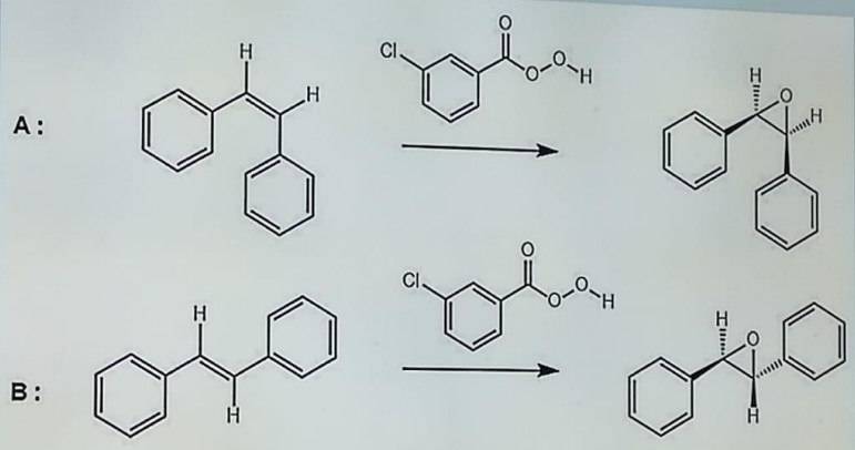

havenly
meso syn
meso syn
reaction steriochemistry is syn?
the product of reaction b is meso?
"Meso syn" is not a homework statement. What is the question you were actually asked?
Determine the actual configurations of the asymmetric carbons in the reaction products. Which is meso?
