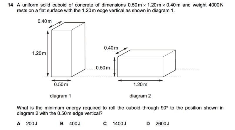

image below
w=f*d
Two diagrams of a concrete cuboid: diagram 1 shows it standing upright with edges 0.50 m, 1.20 m and 0.40 m labelled; diagram 2 shows it lying on its side with a 0.50 m vertical edge and a 1.20 m base.
my attempt:
centre of mass of standing block is at 0.6
and the fallen block is at 0.25
so then change in height = 0.35
and mg = 4000 N
so change in gpe = 4000* 0.35 = 1400J
but wouldnt we take into account that we only have to apply force till the centre of mass is outside of the block so would it still require the force which is equal to its weight
and what about the distance it falls forward? wouldnt that also take force?
correct answer is 200N
You are asked for the minimum energy which has to be supplied to make the block roll over.
Imagine you are doing it. You have to supply some energy to rotate the block through some angle to reach a critical position – and then the block will fall over naturally, without you having to supply further energy.
So the question is: what is the minimum energy you need to supply to get the block to the critical position?
And the underlying question is: what is the ‘critical position’?

Try plotting the position of the center of mass as you rotate through 90 degrees.

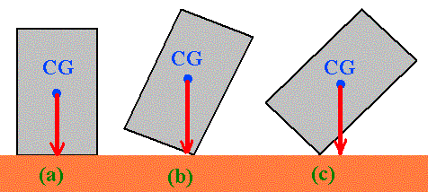

the critical position is option c, a little before that, as soon as cg is out of base...
Three diagrams of a grey rectangular block on an orange surface, each with a blue dot labelled CG and a red downward arrow: (a) upright, (b) tilted with CG above the base, (c) tilted further with CG just past the lower corner.
Diagram of a tilted green rectangular block resting on a horizontal line, with a red arrow labelled CG at its center of gravity pointing down to the line, marked as the line at the end of the base area.
in this green pic, would the block return back or fall over??
What is the position of the CG for these three pictures?
a) equilibrium
b) inside base
c) outside base
the green pic, tip of base
another question for green pic
As you have drawn it, that is rather beyond the critical position. When only a tiny bit beyond the critical position, how much work have you done? Do you need to do any more?
Assuming zero velocity, the green pick is an unstable point like being at the top of a hill.
Try plotting on a grid. You need to quantify the position of the CG.
Another hint: the problem with your calculation is that the end state has lower potential energy than the initial state, so you are calculating energy “released”.
