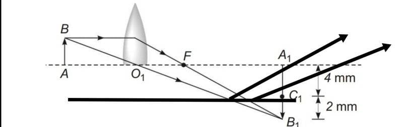

Ray diagram of a split convex lens with a plane mirror between the two halves: object 2 mm tall 20 cm left of the left half-lens, both halves f = 15 cm, 120 cm separation, mirror 4 mm below the axis, 4 mm marked.
I think it will be instructive for you to do part (b) first in order to get your bearings.
First make a ray diagram as if the mirror is not there. Try drawing it to scale as best as possible. As you have already found, you will get a real, inverted image at 60 cm from the first half-lens. Now put the mirror in place. Does it look like the image is still formed at 60 cm or does it look like the converging rays that would have formed the image at 60 cm diverge upon reflection from the mirror?

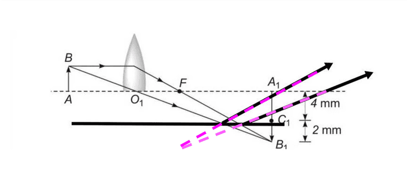

4mm of the object will be formed as a real image at 60cm, while the 2mm part will act as a virtual object, something like this:
Ray diagram of a convex lens with object AB and focal point F, showing rays refracting to form B1 below a horizontal plane mirror, with A1C1 marked 4 mm and C1B1 marked 2 mm.
So yes, the rays will definitely diverge after reflection from the plane mirror. I initially proceeded by considering the real image ##A_1C_1## and virtual object ##C_1B_1## to act as objects for the second lens but got the wrong answer. The book says that we have to consider the virtual image of ##A_1C_1## but why is that? How can a virtual image act as an object? It isn't a virtual object since rays do not converge toward it but rather diverge.
The second lens does not care whether the rays that reach it are reflected off the mirror or emanate undeflected from a real object. As shown in the enhanced diagram below, reflected rays originating at the tip B of the object diverge from a common point of intersection. These rays are then brought into convergence and form a real image of point B to the right of lens 2. What is the horizontal distance from lens 2 that matters for finding the final image?
Ray diagram of a convex lens with object AB on the left, principal axis dashed, focal point F, and a horizontal mirror below the axis forming image B1 with A1 and C1 marked; magenta dashed reflected rays and labels 4 mm and 2 mm.
It should be ##60cm## plus the distance to the imaginary intersection point of the reflected rays, but I'm not sure about how to find the required distance. Any hints?
First imagine the mirror not being there. Also imagine a screen placed at 60 cm from the lens. A real inverted image of length 6 mm, i.e. three times the length of the object, will be seen on the screen.
Now imagine the mirror being slowly raised from below towards the optical axis. As long as the mirror is more than 6 mm below the optical axis, it might as well not be there. All the rays emitted in all directions from a single point on the object and pass through the lens will converge to a single point on the screen: there is a one-to-one correspondence from a point on the object, through the lens, to a point on the screen. When the mirror is exactly 6 mm from the axis, nothing will change and you will still a 6 mm image of the 2 mm object. It follows that if the object were 3 mm instead of 2 mm, you would see the bottom 2 mm on the screen and the top 1 mm will be chopped off.
That's because the rays emanating from the top 1 mm of the 3 mm object are reflected and diverge before reaching the screen; the one-to-one correspondence from a point on the object, through the lens, to a point on the screen is destroyed by the mirror for these points. The take home message is that if the mirror is closer to the optical axis than 3 times the length of the object, the image of the top part of the object is chopped off from appearing on the screen.
Finally, imagine removing the screen. Only the rays that would have converged on it to form the image, now diverge as if they emanated from a single point to reach lens 2. Therefore only part of the real image formed by lens 1 constitutes an object at distance (120 - 60 = 60) cm from lens 2.

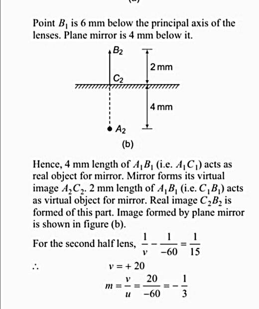

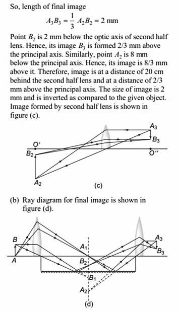

But going by your logic, the object height will ##4mm## and the corresponding magnification at lens-2 will be ##-1/3##. Therefore the final image height would be ##4/3mm##, but the answer is given as ##8/3mm##. Here's the solution:

Yes, I incorrectly assumed, without proving it to myself, that intersection point B2 in your solution does not exist. I now proved that it does exist. Sorry about the confusion.
It seems that you have a complete solution. Is there something about it that you don't understand?

I'm very confused about the role of the plane mirror, so both, the part cut off by the plane mirror and the virtual image formed of the remaining part of the original real image act as a virtual object for the second lens?
To become unconfused, I think that you should set aside equations and virtual objects and concentrate on what it means to "see" an object such as the upright arrow AB on the far left of the figure in the solution. I hinted at that in post #8.

Now you are ready to understand what's going on with this problem. Imagine that the second half-lens on the right is the lens of your eye. Figure (c) in the solution shows what you would see, an arrow with its tail at A2 and its tip at B2. As far as lens 2 is concerned it is a real object because at line A2B2 light is emitted in all directions left to right.
