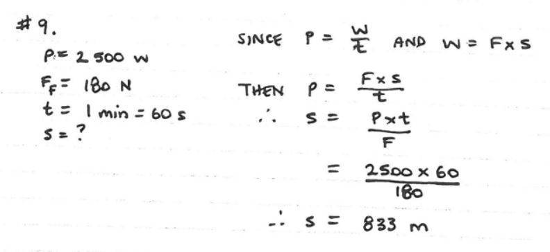

A motor car with a power output of 2500W is moving against a constant frictional resistance of 180N. What distance does it travel in 1 minute on a horizontal road?
P = 2500W
FF = 180N
t = 60s
s = ?
P = W/t
W = Fs
Fnet = FA - FF
P = W/t
2500= Fs/60
s = 150000/F
??I don't know where to go from here as I only know the frictional force??

Yes, my teachers answer and working is attached to this msg however he often gets these questions wrong. He has assumed that the net force is 180N which is where I am lost
It's traveling at a constant speed. Its engine has to overcome only friction.
The question should have stated that it's a constant speed situation.
Are you okay now?
Doesn't that make the net force equal to 0?
Yes, the net force on the car would be 0 if it's moving at a constant velocity and the net work done on the car is therefore also equal to 0. However, the motor has to apply a force to counter the frictional resistance which puts a limit on the maximum speed of the car (P=Fv)
Essentially, the problem having you solve for the distance traveled by the car when it's moving at its maximum speed for the power output listed.
