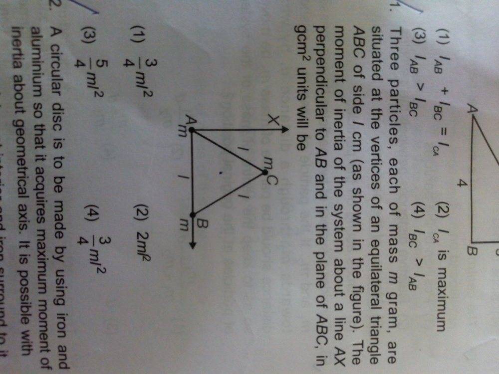

Three particles each of mass m gram,are situated at the vertices of an equilateral triangle ABC of side l cm(as shown in the figure).The moment of inertia of the system about a line AX perpendicular to AB and in the plane of ABC in gcm² units will be:
1. (3/4)ml²
2. 2ml²
3. (5/4)ml²
Moment of Inertia I=summation
of(MR²)
If I take the three masses individually and try to calculate the moment of inertia of the system separately then
I=(m*0²)+(m*(l/2)²)+(m*l²)
=ml²/4 +ml²=(5/4)ml²
But If I try to calculate Moment of Inertia of the system using its Centre of mass then
As centre of mass is located at the the centroid,
I=3m*(l/2)²=(3/4)ml²
Acc to my book option 3 is correct.Why is my second method wrong?
I do not understand your second method. How do you arrive at 3m*(l/2)²? Are you familiar with the parallel axis theorem?

what is the MoI of the trio of points about a line through its mass centre and parallel with AX?

Is it:
m*(l/2)² +m*(l/2)²=ml²/2

`That's right, that is the MoI of the system about an axis parallel to AX passing through the centre of mass. To get the MoI about AX, as @haruspex said you need to use the parallel axis theorem.
This is just saying that if you know the MoI about an axis passing through the CoM to be ##I_0##, then the MoI about an axis parallel to that one is ##I = I_0 + m_t d^2## where ##d## is the distance between the axes and ##m_t## is the total mass of the system.
Hopefully you will get the same result as before for method 1, otherwise Physics has failed us!

Sure, because treating the whole mass as concentrated at the mass centre is simply not a valid way to find the MoI.

Yes. I=ml²/2 +3m*(l/2)²=(5/4)ml²
So that is the correct Method 2

Systems with the masses more spread out from an axis will have higher rotational inertia. If you sit on a swivel chair and hold two heavy books with your arms stretched out, it's going to be harder (i.e. require more torque) to produce some value of angular acceleration than if you sit with the two masses right next to you. The total mass of the system might be the same, but the moment of inertia differs in the two scenarios because of the distribution of mass.
Treating a system with the mass concentrated at the centre of mass would sort of defeat the point!
