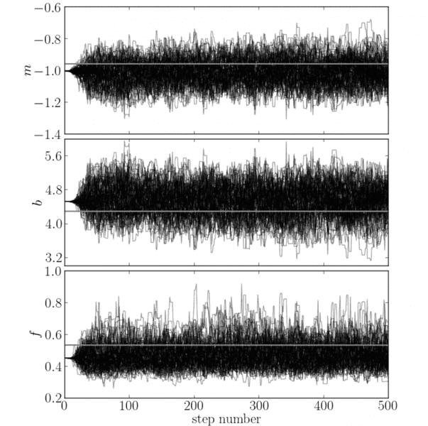

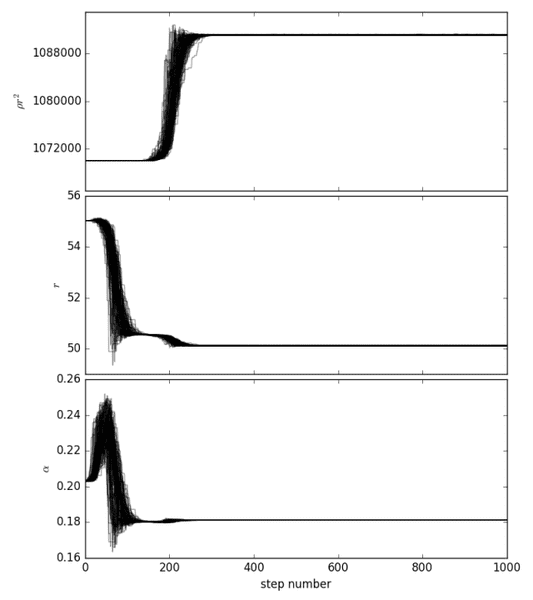

Hello I use a python package called emcee to fit a function to some data points. The fit looks great, but when I want to plot the value of each parameter at each step I get the plot.png below. In their example (with a different function and data points) they get the plot1.png image. Why is my function converging so fast, and why does it have that weird shape in the beginning. I apply MCMC using likelihood and posterior probability. And even if the fit looks very good, the error on parameters of function are very small (10^10 smaller than the actual value) and I think it is because of the random walks. Any idea how to fix it?

That looks like it is just the burn in period. Usually people just discard the first few thousand points in order to avoid that.
I have done all of my MCMC work in R, so I am not familiar with the Python package you mention, but it looks like it is either set with a burn in of 0 or it plots the burn in samples.
If you're using emcee something like this will help overcome the burn in:
sampler = EnsembleSampler(...)
pos, prob, state = sampler.run_mcmc(...)
sampler.reset()
sampler.run_mcmc(pos, 1000, rstate0=state)
