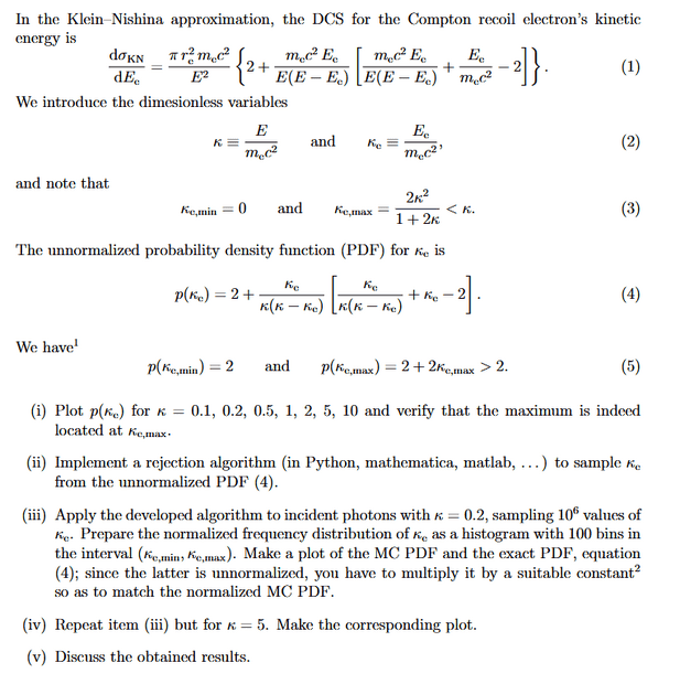

I'm working on this Monte Carlo simulation problem for radiation propagation.
So far I think I have accomplished creating a histogram of simulated values (iii). Now I need to plot it against the exact PDF. I need to find the normalized PDF, but can't obtain the normalization constant, and so on. Or maybe it is working but my histogram is incorrect?

Note 2 hints that the normalizing constant should be ##p_{MC}(0)/2##.
Yes, I know that. I am struggling to code for that. Not sure what ##p_{MC}(0)/2##, since it’s not an equation, but a simulated histogram of counts.
And is my code correct so far?
Update: I realised there is something wrong with my histogram, and currently working on it.
