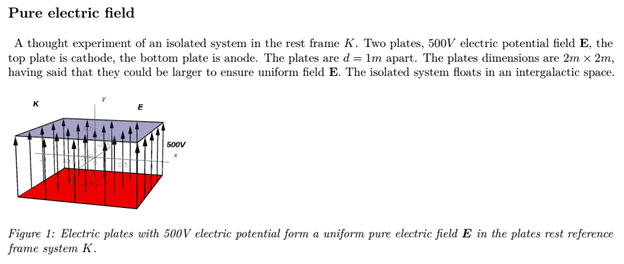

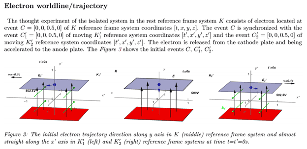

Here is a thought experiment:
An electron flies from the middle of the cathode plate to the middle of the anode plate.
Now here is what is happening mid flight:

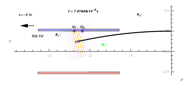

... and the K'2 frame:
We pick electron Q charges as per the figures above.
When the calculation is done then the result is following:
The repulsive Lorentz force between qQ1 is bigger than qQ2 in K'1 frame.
The repulsive Lorentz force between qQ2 is bigger than qQ1 in K'2 frame.
The Lorentz force is causing clockwise rotation of the plates in K'1 frame.
The Lorentz force is causing counter clockwise rotation of the plates in K'2 frame.

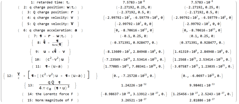

Here are the definitions:
The calculation, middle column is Q1 and the right column is Q2:

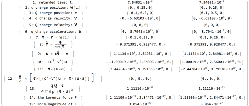

The rest frame calculation:
