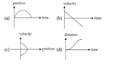

All the graphs below are intended to represent the same motion. One of them does it incorrectly. Pick it up (Please see the attached Image)
v=dx/dt
a=dv/dt
I think Option C should be correct
since the body has two velocities in the same position which is not possible. They even didn't show an arrow that could tell it has which velocity at its starting point and at the ending point
But the given and in my textbook is Option d ( It can have an error also).
Plz, can you also give your opinion? Which option do you think is correct also please give a reason.
If you have a pendulum clock, can the velocity at the bottom of the arc be different for the forward stroke compared to the return?
No, it should be the same, but in opp direction. Is that correct?
Oh! so that graph in which the Velocity is different at the same position is correct. I actually thought that it can't have different velocities at the same position at the same instance but it can happen at two different instances.
But how is the option d correct then? Cant we draw a distance Vs Time graph like that? Also, distance is not decreasing with time so it should have been the correct graph.
Two exercises:
1) Sketch the four corresponding graphs for a ball thrown initially vertically upwards and then falling back to its start point.
2) If graph a) is correct, what should graph d) (the distance-time graph) look like?

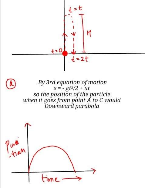

I think graph a is correct because
Hand-drawn diagram of a particle thrown upward from t = 0 to a maximum height H, then falling back to the ground at t = 2t, with a dashed trajectory arc; below, a sketched position versus time graph shows an upward-opening curve rising then returning to zero.
So distance would be just flipping the graph from That point where the derivative becomes zero to the point where it intersect X-axis
It would look something like this
Hand-drawn red curve of position against time, rising to a peak then falling back to zero, with a blue arrow and dashed line marking the peak; a blue arrow points to a second graph of distance against time, a curve starting at the origin, flattening, then rising steeply.
Also by first equation of motion Graph of V vs t would be similar to that in the option and Graph of V vs position would also be similar to that in the option
Now i think all graphs given in the ans are correct . None of the option is correct.
Is it so?
Is it so?
I agree with your graphs (for the case of a ball thrown upwards). But note that your distance-time graph does not look like graph (d) in the question.
For example your distance-time graph, at the instant height is maximum, has a gradient of zero. This is not true for graph (d) in the original question. (And note the gradients of these graphs have special meanings.)
That is correct. And since velocity is a vector, that means that you have one position where the velocity has two values.
Yes, I got the answer now(it should be d)
Thanks for Help 😊

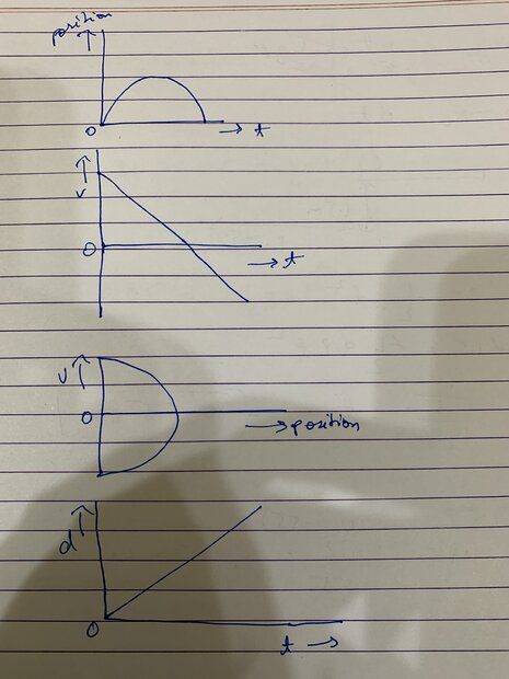

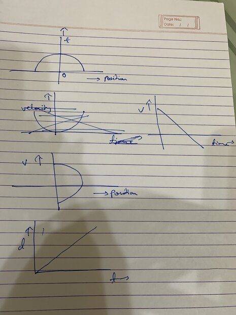

Steve4Physics said:
Sketch these 4 graphs:
position vs. timevelocity vs. timevelocity vs. positiondistance traveled vs. time
1. Ball
2. Pendulum
I don’t know about the motion of a pendulum. Excuse me for wrong graphs
  • Four hand-drawn graphs on lined paper: position against time as an arch rising then falling to zero; velocity against time as a straight line falling from positive to negative; velocity against position as a symmetric curve opening to the right; acceleration against time as a straight line rising from the origin.
  • Handwritten notebook page with four hand-drawn sketches: a position-time curve shaped like a half arch, a velocity-position style curve with a downward-sloping velocity against time line, a velocity-against-position curve, and a distance-against-time straight line through the origin with labels d and t.
rudransh verma said:
1. Ball
2. Pendulum
For the ball, your first 3 graphs look good. But you have drawn your distance-time graph as a straight line. Are you sure?
Is the distance-time graph related to the position-time graph?
What does the gradient of a velocity-time graph tell you?
What does the gradient of a distance-time graph tell you?
For the pendulum, you have only drawn graphs for half a cycle and (apart from velocity-position) the graphs are wrong. If you are interested in finding out why, it would probably be best if you started a separate thread as we have drifted away from the original topic.
An interesting exercise would be to make a simple pendulum, watch it carefully, and see if you can get the shape of the graphs directly from your observations.
