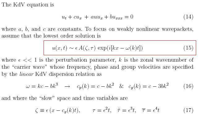

One more question regarding KdV equation.
I am currently reading an article:
www-personal.engin.umich.edu/~jpboyd/op121_boydchennlskdv.pdf
and a paper. (Please see the attached figure)
Both of them assume the perturbation series of the velocity start from O(epsilon), how come?
It is somewhat counter-intuitive to me since we always assume something like
u ~ u0 + eu1+ e^2u2 +... isn't it?
why does this start from eu1 without the constant velocity u0?
Can you please explain?
