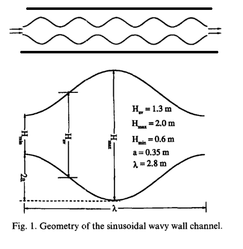

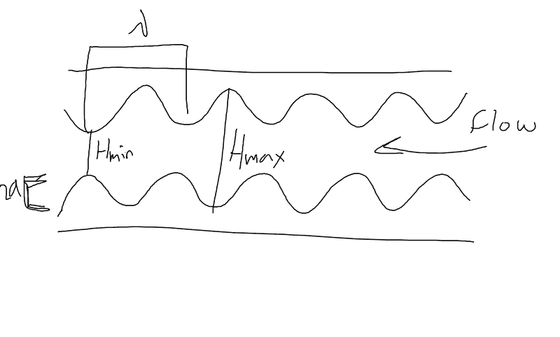

Hello,
For a project I am working on, I am trying to design a 2D with parallel sinusoidal patterns. Imagine a 2D section of a pipe (two parallel surfaces with distance in between). Each surface is basically a sine function. Peak points meet with each other, as well as troughs. Liquid is intended to flow through the topography. The 2D section is solid. Using Sine function phase shift I can establish different amplitudes and wave lengths. My question is, given that I decided on a certain corrugation geometry, how can I measure the roughness of the pipe ? This 2D pattern (consisting of two parallel sine functions), will be 3D printed onto glass. I understand that I can modify and transform the sine wave and establish different amplitude lengths and heights. However, I couldn't figure how to measure the roughness between these plates. I have looked at Relative roughness and other definitions. However, I am not sure I want to apply these simple formulas to my case. I want to account for the entirety of the topography (top and bottom sine waves) and take inconsideration the whole shape and it's effect on roughness. The other formulas give averages.
Will your flow be laminar or turbulent? If turbulent, does the roughness fit on a Moody chart? What is the ratio of channel width in the "roughness direction" vs the perpendicular direction (which is presumably smoother?).

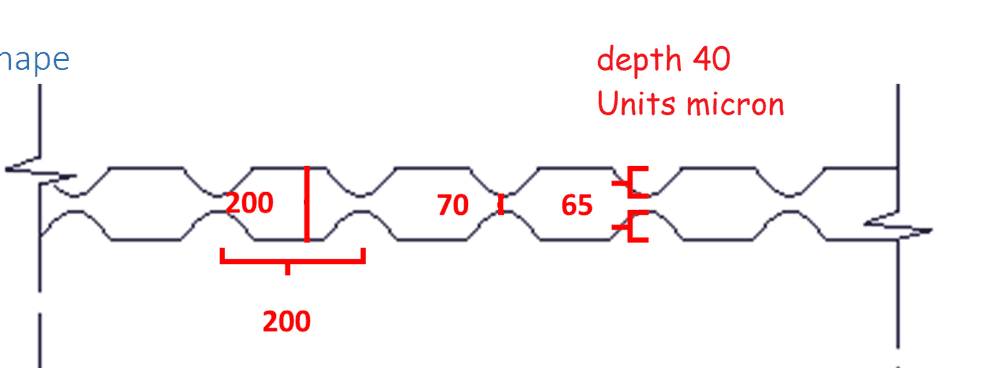

I haven't looked into whether the flow is laminar or turbulent. The working conditions are 2900 psi and flow rate of 40ml/h (flow rate is subject to change).
Please find the attached picture for further explanation. My aim is to co-relate a roughness magnitude with the length, height, spacing and number of amplitudes.
A lot depends on whether the flow is laminar or turbulent. That really needs to be calculated first. Even if it's only a rough estimate.

You have two rough and two smooth surfaces. Read through HDS5 Hydraulic Design of Highway Culverts (available online for free). They discuss how to deal with a similar problem. It may give you some ideas.

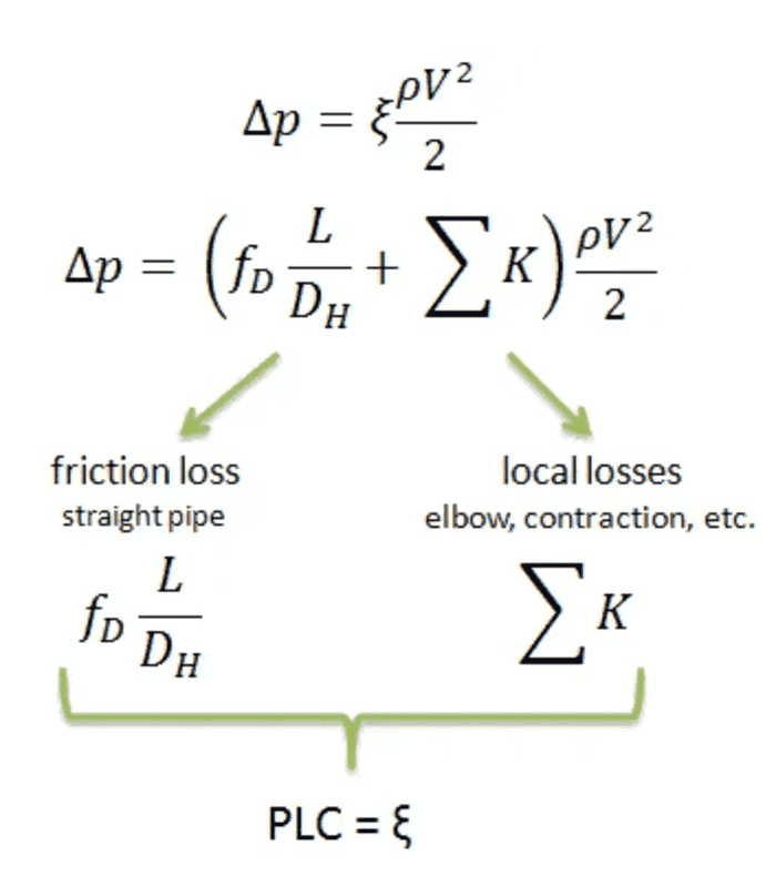

I have measured the delta P for the channel and I can measure the total Drag coefficient Cd = 2a deltaP/(roh)U^2...however, since I have corrugations on both sides of the channel the equation becomes 4a deltaP/ (roh)U^2. Assuming the equation does measure the total Cd and I don't have to multiply it by n (number of corrugations), how can I separate the drag force into drag due to form and drag due to friction with my channel design?

I wish to measure the drag coefficient and skin friction instead of roughness using theoretical analysis. Is stokes law the only way?

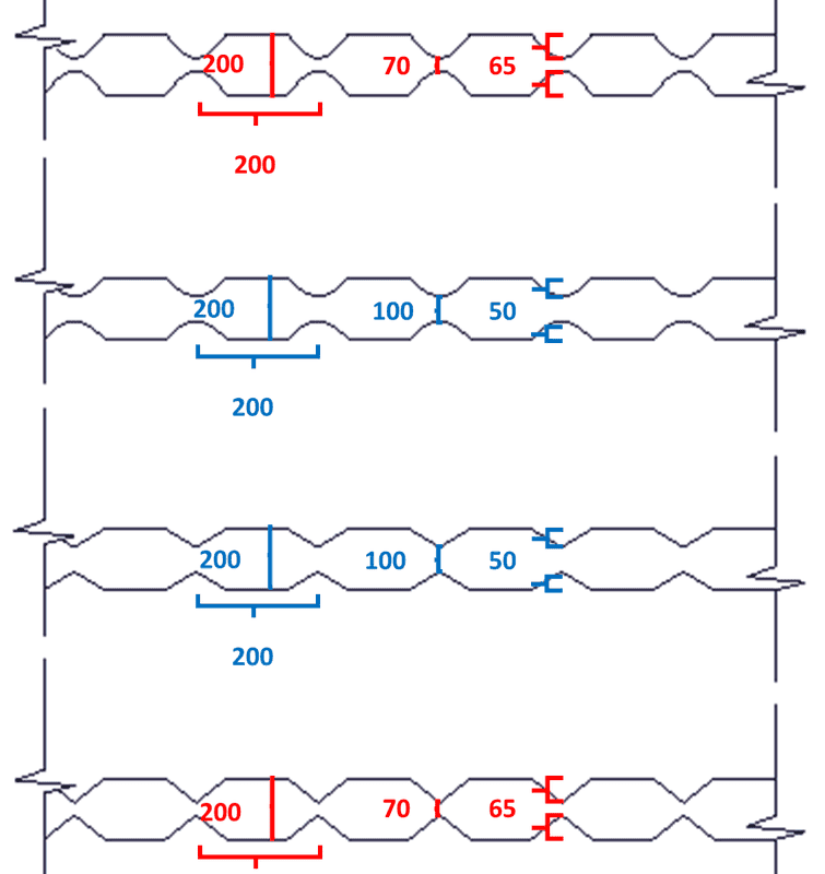

It sounds like you want to predict pressure loss vs flow rate through rectangular channels of varying geometry. Drag coefficient does not apply to flow through channels. A relevant parameter is hydraulic diameter (search the term). Since you have laminar flow, the pressure drop is probably mostly skin friction. I am not aware of any published method for calculating pressure drop in your situation. If I wanted to develop such a method, here is how I would do it:
Start by making a set of straight channels. One 200##\mu## wide, one 70##\mu## wide, and one at the mean channel width one of your channels. Then I would measure the pressure drop vs flow for those three channels and several actual channels. I would compare the measured pressure drops to that of the three straight channels.
I would calculate hydraulic diameter and Reynolds number for all channels three ways - at the maximum width, minimum width, and average width. Then I would use those numbers in a Moody Chart to see how well they predict actual pressure drop.
