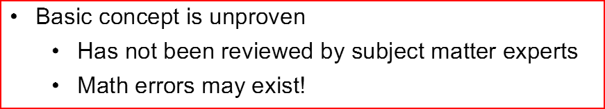

Does this violate conservation of momentum or some other law? It claims to take advantage relativistic mass increases to achieve propulsion
A new concept for in-space propulsion is proposed in which propellant is not ejected from the engine, but instead is captured to create a nearly infinite specific impulse. The engine accelerates ions confined in a loop to moderate relativistic speeds, and then varies their velocity to make slight changes to their mass. The engine then moves ions back and forth along the direction of travel to produce thrust. This in-space engine could be used for long-term satellite station-keeping without refueling. It could also propel spacecraft across interstellar distances, reaching close to the speed of light. The engine has no moving parts other than ions traveling in a vacuum line, trapped inside electric and magnetic fields.
https://ntrs.nasa.gov/archive/nasa/casi.ntrs.nasa.gov/20190029657.pdf
It does if they are claiming that propulsive force can be obtained. You can't produce an external force on an object by rearranging its internal parts. It looks like that's basically what this is trying to do.
Instant reaction: if he's bouncing charged particles backwards and forwards then he's generating changing EM fields - i.e. radiation. If this works at all, it's a complicated photon rocket. If it doesn't emit radiation then, as Peter says, I can't see how it could possibly work.
What is it with these NASA yahoos? At least he's honest at the end of the presentation...
Slide with a bulleted list in a red-bordered box: "Basic concept is unproven", with sub-bullets "Has not been reviewed by subject matter experts" and "Math errors may exist!"

The EM is a distraction. The device as described is functionally equivalent to a wheel mounted on an axle running the length of the ship. The wheel is free to slide along the (frictionless) axle. You start with the wheel, unspinning, at the back of the ship, and push it forwards. As it slides towards the front of the ship at constant linear velocity, you spin the wheel up to relativistic speeds, so when it strikes the front wall it has increased relativistic mass. It bounces off the front wall and returns, being spun down as it does so. Rinse and repeat.
The argument is that the wheel has more relativistic mass when it bounces off the front wall than when it bounces off the back wall, but the same linear speed. Therefore we get a net push forwards. The flaw is in believing that you can spin up the wheel while it maintains a constant linear speed without needing to apply any component of force parallel to the axle. This is only true if the linear velocity is zero, in which case the wheel never hits either wall. If it's moving, the extra momentum from the bounce off the front is compensated by the momentum the ship lost spinning up the wheel (edit: from that component of force parallel to the axle).
Short version: force and acceleration are not always parallel in relativity. Spinning up the wheel while it's in motion slows the ship, so the wheel bouncing off the front restores it to its original speed. It's a textbook free energy device, with a textbook free energy device inventor's mistake of not quite grasping all of the physics.
