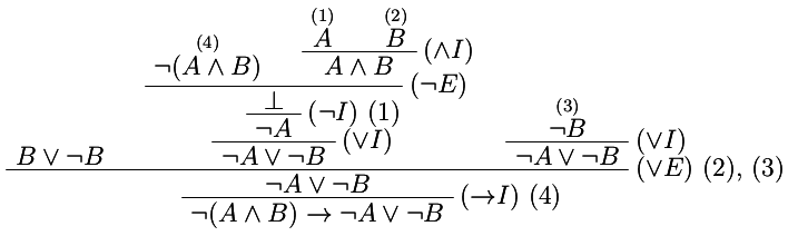

If we are talking about the number of lines, then we should describe the inference rule more precisely. After all, the following derivation is also natural deduction (in tree form).
I assume you are using the so called Fitch-style calculus. Then you can have something like the following.
