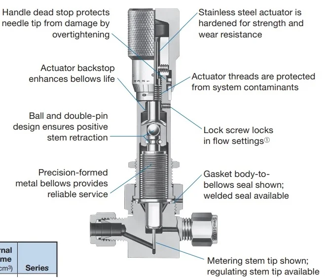

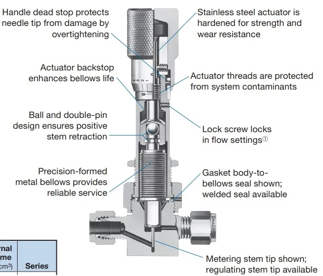

Any valves should be bellows sealed to eliminate leaks past the valve stem. The image below is of a Swagelok bellows sealed flow regulating valve:
The above valve is not the right valve for a shutoff application. It is the first diagram that I found in a quick search that clearly shows how bellows sealed valves work. Search terms bellows sealed valve will find numerous manufacturers of these valves. One such manufacturer states on their web site: "Every bellow assembly is helium leak-tested to assure zero leakage."
Thank you for the hint! :o) Swagelok valves look really very well engineered, very clever design! However, keep present that in my application a safety valve, theoretically, isn't even necessary at all. The pressure case is hermetic, filled with helium, and no combustion or uncontrolled addition of any gas can take place. Helium pressure is only a function of temperature, and temperatures higher than the normal operation values (already very hot per se) are possible only in case of a catastrophic event, like a fire in the room. So the safety vent is something that would operate only if a larger scale disaster occurs. In that case, there would be much serious problem to care about... the purpose of a safety valve would be only to avoid adding disaster (pressure vessel explosion) to disaster. A safety valve will NEVER open under less-than-disaster conditions. For that reason, and also because of the absolute hermeticity guaranteed by a burst disk, it's better to have a device that opens and stays open, rather than a valve that could give off - unnoticed - a small quantity of gas, that one would never know unless installing a detection system at the valve outlet. A rupture disk is much more economical, reliable, hermetic, and its operation cannot go unnoticed.
