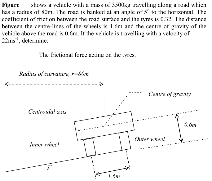

Diagram of a vehicle on a banked road with a 5 degree angle, showing the radius of curvature r = 80m, the centroidal axis, centre of gravity 0.6m above the road, inner and outer wheels, and the 1.6m distance between wheel centre-lines.

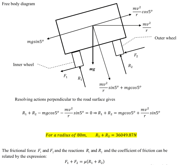

Free body diagram of a vehicle on a banked curve showing weight mg, centripetal force mv^2/r components, reactions R1 and R2 at inner and outer wheels, and friction forces F1 and F2.
Basically I don't agree with this solution, I think it is R1 + R2 - mgcos5 + mv^2sin5/r = 0. Can you help me please?
thanks!
Basically, I don't like that for ΣF it takes the fictional inertial force opposite to centripetal force, instead of taking the actual centripetal force. Isn't this wrong?
Second thing I don't know is the direction of the centripetal force in such situation: isn't it from the centre of gravity of the vehicle towards the centre of the circular motion? Ie. isn't it PARALLEL to the surface of the banked road? Because here, he has it parallel to the horizon, instead of parallel to the banked road!
You should see is as: ##R_1+R_2-mg\cos 5^\circ## contribute a fraction ##\sin 5^\circ## to the actual centripetal force ##mv^2/r##.
The presentation is somewhat suggestive: ##\sum F = 0## would mean uniform linear motion, not a circular trajectory. Here ##\sum F \ne 0##. In fact, ##\sum F= {mv^2\over r}##.
The drawing is correct. Note how the radius is specified.
Centripetal force is a resultant force, not an applied force. It is the component of the resultant that is normal to the direction of travel. Where the speed is constant, that makes it the entire resultant: ΣFother=Fcentripetal.
Centrifugal force is a fictional force, but is an applied force, not a resultant: ΣFother+Fcentrifugal=0.
Since centripetal and centrifugal are equal and opposite, the equations are the same.
The vehicle is describing a circle in a horizontal plane. The centre of that motion is therefore in that plane, not down the bottom of the slope.
