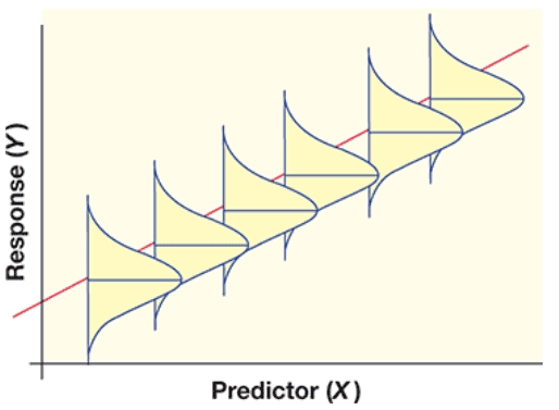

Hello,
In reviewing the classical linear regression assumptions, one of the assumptions is that the residuals have a normal distribution...I also read that this assumption is not very critical and the residual don't really have to be Gaussian.
That said, the figure below show ##Y## values and their residuals with a normal distribution of equal variance at the ##X## value:
To check for residual normality, should we check the distribution of residuals at each ##X## (not very practical)? Instead, we usually plot a histogram of ALL the residuals at different X values...But that is not what the assumption is about (normality of residuals for each predictor ##X## value)...
Thank you...

True. A lot depends on the subject matter expertise of the statistician. Does he have a valid reason to model the subject as a linear model with a random normal term?

The assumption of a Gaussian error structure is not part of the basic regression assumptions. IF that assumption is added then things like the distributions of the LS estimates are exact rather than approximate as they are without it.
When the Gaussian assumption is made it is this: the error terms are i.i.d normal with mean 0 and variance sigma squared. This links to your picture of the bell curves superimposed on the regression line as follows:
- in this case Y1 through Yn are each normally distributed with mean b0 + bx1 and variance sigma squared
- the bell curves on the regression plot don't show the distribution of the errors, it is meant to show each normal distribution of the Y values
This leads to your question: we don't need to check the error distribution for each value of x since those values don't influence the error distributions: the error distributions are, as I mentioned above, i.i.d with mean 0 and constant variance, so the checks we use on them work
You should also remember this: there is no such thing as any data that is truly normally distributed: that is an ideal, and our checks are done simply to see whether our collected data's distribution is similar enough to that of the ideal to allow us to use normal-based calculations.
