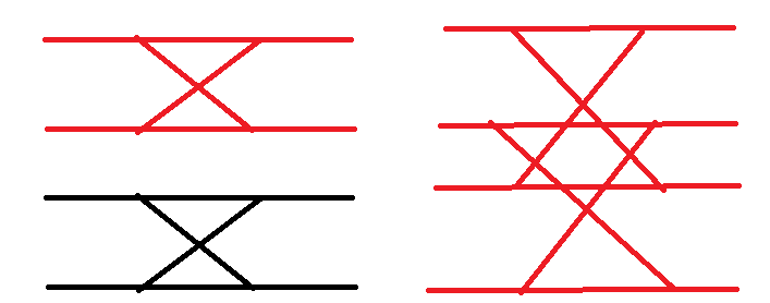

A suggestion for proof via induction from me. Please correct me if you find any mistakes! A confirmation would be nice!

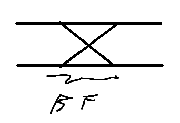

A butterfly (BF) in an FFT-diagram looks like:
Notice, the number of multiplications corresponds to the number of butterfly operations.

Base case
: For ##n = 2##, the number of butterfly operations is ##(2/2)\cdot \log(2) = 1##, which is true. See the picture above it shows the base case.
Inductive step: Assume the statement is true for ##n = 2^k##, i.e., the number of butterfly operations is ##\frac{2^k}{2} \log 2^k = 2^{k-1} \cdot k##. We need to show it holds for ##n = 2^{k+1}##.
For ##n = 2^{k+1}##:
- The FFT algorithm splits the problem into two FFTs of size ##2^k## and then combines the results with ##2^k## butterfly operations.
- By the inductive hypothesis, each FFT of size ##2^k## requires ##2^{k-1} \cdot k## butterfly operations.
Thus, the total number of butterfly operations for ##n = 2^{k+1}## is:
$$2 \left(2^{k-1} \cdot k\right) + 2^k = 2^k \cdot k + 2^k = 2^k (k + 1)$$
Now, we need to verify that this matches ##\frac{2^{k+1}}{2} \log 2^{k+1}##:
$$\frac{2^{k+1}}{2} \log 2^{k+1} = 2^k \log 2^{k+1} = 2^k (k + 1)$$
Thus, the inductive step holds.
By mathematical induction, the number of butterfly operations in an FFT circuit is ##\frac{n}{2} \log n## for ##n = 2^x## where ##x > 0##.
