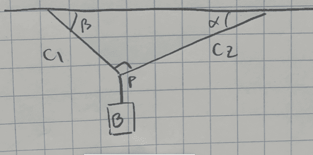

A book is at rest suspending from 2 cords (C1 and C2), and C1 is shorter than C2. The book pulls on the meeting point P of the cords with a force of 10 N. All cords also exerts a force on the Point P. The angle between the strings at P is 90 deg.
True or false:
1- F(C2/P) > F(C1/P) must be true
2- F(C2) > 10 N may be true
3- Vector sum of forces by C1 and C2 is straight up
4- F(C2/P) points downwards to the left
5- The magnitude of the vector sum of the forces exerted by C1 and C2 is greater than 10 N
NetF = ma
Here is where I am at :
1- F(C2/P) > F(C1/P) must be true I believe this is false, considering the angle separating C1 from the 'ceiling' is bigger
2- F(C2) > 10 N may be true I believe this is true because F(C2) could be broken down into vector components which may go above 10 N
3- Vector sum of forces by C1 and C2 is straight up True because the book is resting
4- F(C2/P) points downwards to the left False because it points up to the right ?
5- The magnitude of the vector sum of the forces exerted by C1 and C2 is greater than 10 N False because it must be equal to 10 N if the book is at rest?
Please help!
Here is a little diagram if it helps clarify some things :
Thank you for any help!
Answers 3-5 are correct for the reasons you give. To verify your answers for 1 & 2 consider this: If you do a geometric addition of the three vectors, you will see that they form a closed triangle because their sum is zero. What kind of relations must the sides of a triangle obey?

Well, then C2 can't be larger than 20 N because it isn't a hypothenuse. But what is the third vector you are talking about, just so I don't confuse myself?

The weight

Hm.I don't think this is correct. Try to make free body diagram

As what @Father_Ing said, try to make the free body and calculate the forces in x and y direction using F = ma.
You will find the value of both tensions

Intuition can be faulty. Try reasoning. Draw the right triangle, label the sides and provide reasons for your answers. That's the short way. The long way is to draw a free body diagram, find the tensions and use the fact that β > α.

You need to understand this simple problem before you advance to more complicated ones.
See figure 6.3 in this link:
https://courses.lumenlearning.com/s...apter/6-1-solving-problems-with-Newtons-laws/
Start by re-arranging the cords and angles in such a way that the set up is symmetrical.
Then, make α=90° and β=90°, so C1 and C2 become both vertical:
F_y_C1=F_y_C2=0.5gm_B
Then, make α=45° and β=45°, so C1 and C2 become perpendicular to each other:
F_y_C1+F_y_C2=gm_B
Because of the above, the magnitudes of F_C1 and F_y_C2 must be greater.
Lastly, break the symmetry and make α=30° and β=60°, so C1 and C2 remain perpendicular to each other, as your problem states.
Now, being in lateral balance, the system must comply with
F_x_C1=F_x_C2
In order for that to happen, how F_y_C1, F_y_C2, F_C1 and F_C2 must naturally re-adjust their magnitudes to keep a vertical balance of forces?

Please show your drawing. It should be a right triangle with sides C1, C2 and angles α and β labeled. Then provide reasons why you answered the first two items the way you did on the basis of what you see in this triangle. It may be that you drew the wrong triangle.
