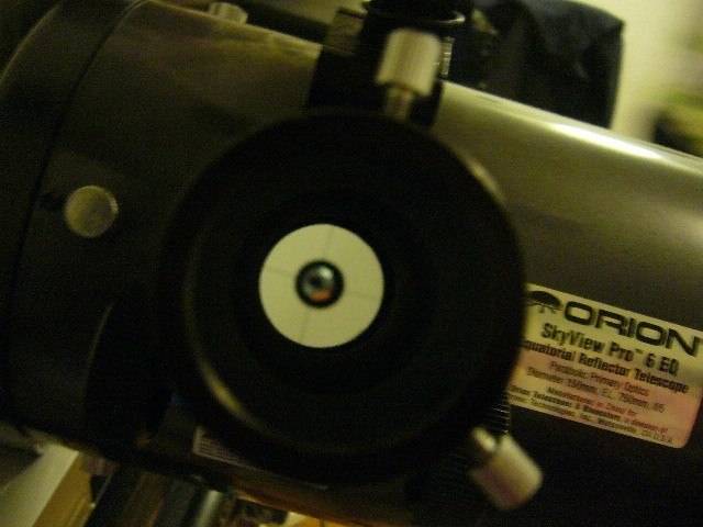

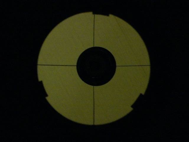

What do i need to adjust for this situation? The primary or secondary mirror or the eyepiece?
Thank You.
Here i got the actual picture of what i can see after collimation: I would like to ask if i did it correctly? (im asking because its quite hard to determine to middle point)
I would like to state that you can't my eye in the picture, but my eye is centered within the smaller circle.

Thank you for the help. My previous question is no longer valid since i got myself a laser collimator (for around USD$40)
