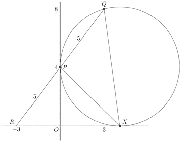

Point $Q$ lies at $(3,\,8)$ and point $P$ lies at $(0,\,4)$. Find the $x$ coordinate of the point $X$ on the $x$ axis maximizing $\angle PXQ$.

Solution from Opalg:
If $X$ is a point on a circle through $P$ and $Q$ then the angle $\angle PXQ$ will be inversely proportional to the radius of the circle. So we want the smallest radius for which the circle intersects the $x$-axis. In other words, we want the circle to be tangent to the axis at $X$.
Let $R$ be the point $(-3,0)$ at which the line $QP$ meets the $x$-axis. The length $PR$ is $5$ units (because $OPR$ is a 3-4-5 triangle). Similarly $QR = 10$.
A euclidean theorem says that $RX^2 = RP.RQ = 5\times 10 = 50$. Therefore $\boxed{OX = \sqrt{50} - 3 \approx 4.071}$.
Note 1. It looks from the diagram as though the circle is tangent to the $y$-axis at $P$. In fact, it is not. If $OP$ was a tangent, it would follow that $OP = OX$. But the $y$-coordinate of $P$ is $4$, just fractionally different from $\sqrt{50} - 3$.
Note 2. For completeness, one ought to add that there is another circle through $P$ and $Q$ that touches the $x$-axis, at $(-3-\sqrt{50},0)$ on the negative axis. But the radius of that circle is much larger than that of the circle in the diagram, so the corresponding angle is smaller.
