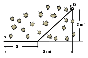

A hiker starting at point P wants to get to a forest cabin, which is two miles from the road at point Q (See diagram). The hiker can walk at 6.00 mph on the road and 2.50 mph through the forest. Suppose the hiker walks a distance X down the road before cutting through the forest, straight to the cabin. Determine the value of X for which the trip take the least time. Consider the distances to be good to three significant figures.
[/B]
Trigonometry and Derivatives
I attempted to draw the lines again and label points to simplify the triangle. However, I am getting stuck on how to optimize the walk.

Add two more labels to the diagram. Label the point where the walker leaves the road A. The point on the road that is nearest to point Q label point R.
I want you to use symbols for the given values, not the numbers. Use PR instead of '3 miles' and QR instead of '2 miles'. Use u instead of 6 mph and v instead of 2.5mph. This is a useful habit to get into. You already have x for the (unknown) distance walked on the road.
Try to answer these questions in sequence:
In terms of these symbols, how long will the walker be on the road?
How far will the walker go through the forest? How long will that take?

So the how long walk on the road= (PR-x)/u?
time = distance/velocity
So
time = x/u
So to find how far walked through the forest would it be [sqrt(QR^2+AR^2)]/v which would find that straight diagonal line? Or would I have to use angles?
Pythagoras works fine. No need for trig.
So now you have expressions for the time of each leg, the total time is just the sum of these.
Note that you'll need to express AR in terms of x.
You mention derivatives in the OP so I assume you know about minimisation problems?
I understand derivatives, but I never really used them with minimization problems. How would you go about using a derivative to do that?
If you have an independent variable x and a function of it f(x) that you want to find either a local minimum or local maximum of, you look at the derivative f'(x) of f (df/dx). At a point that is locally a minimum, a small change in x either way will increase f, so f' will be negative on one side of x and positive on the other. Right at the minimum, f' will be zero.
