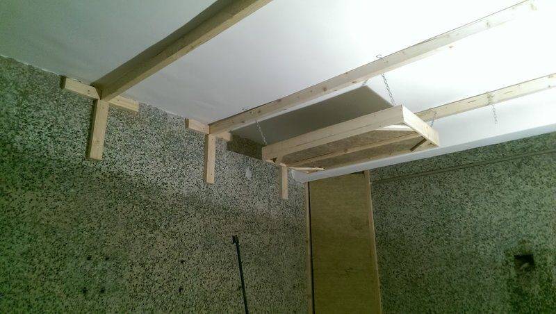

Sorry, I explained poorly. The mineral wool is inside the frames already. The end result should look something like this (one panel 8 kg):
berkeman said:
it looks like he is trying to run his own beams under the ceiling. [
Exactly! The beams are not attached to the ceiling at all, because the ceiling looked suspicious. Beams are attached to side walls of the room (only 3,5 meters across). They are attached properly (concrete walls), and I have no worries that they will hold, I think I could hang a horse from those beams. Just for testing, I put one of these beams on two bricks at each end, and tried jumping on the middle of the beam, it didn't budge, and I'm 95 kg light :). Max total weight per beam will be around 16 kg, and not all in one point (4 times half of one panel = 8 connections x 2kg). To clarify, I will have two panels hung between two beams, 8 panels total. This means I need 5 beams. Each panel is 8 kg. This means that the first and last beam will suspend only half of two panels (8kg total), while center 3 beams will each suspend 2 times half a panel from each side = 16 kg.
Also, I won't use wires but chains to hang the panels.
I was worried because the panels won't hang directly under the panel - the chains will be at an angle (as on my original photo). I guess I shouldn't worry too much, but better to ask than have something fall on my head :)

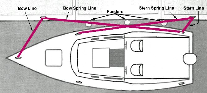

Two chains from one point on the panel to two different points on the ceiling will prevent the panel moving from in the plane of the triangle. Triangles in structures make them strong. Think of guy ropes and skeleton framed towers. Without some 'triangles', (with just parallelograms) your panels can swing from side to side. You can use common points on the ceiling for attaching two panels to achieve what you need. (Or criss cross the chains above each panel - any arrangement will keep it steady and you are not dealing with hurricane force winds!)

This is an example of what I meant. :smile:

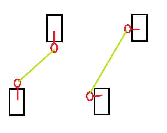

I might be too late, but how about the arrangement on the right instead of the one on the left:
Not only the angle is less pronounced (even less if you can put the hook on the outside on the bottom beam), but the screw are in shear instead of tension, which I think is better because there is a better chance the wooden threads strip by pulling on it than the metal hook breaks.

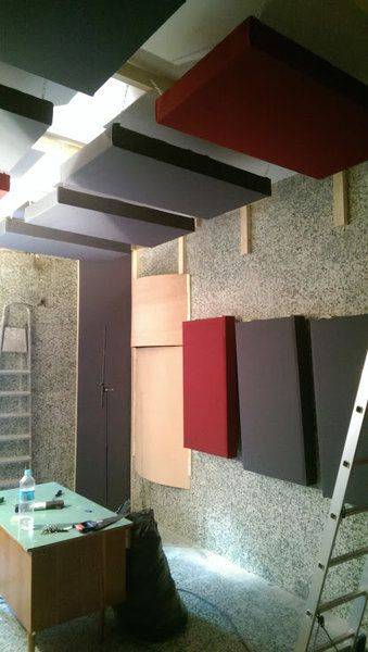

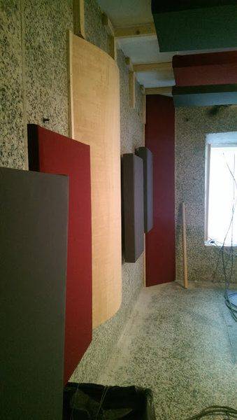

Hello everyone, this project kind of got delayed, I finished it much much later than planned, so I forgot to post pictures here. It actually isn't 100 % finished, because the owner ran out of money for other necessary equipment.
I just remembered today when I wanted to post some other (unrelated) question. Not very nice of me, I know :)
Again, not finished, but here are some pictures (ceiling and side wall absorbers + two large poly-cylindrical diffusors, which double as low frequency absorbers).
And THANKS FOR THE HELP!
