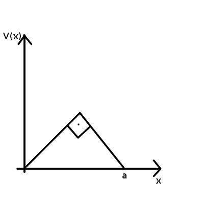

This plot of potential function
Your function is not the same as the plot. -kx is negative in the range a/2<x<a
By the way, the drawing shows a hill instead of a well.
ehild

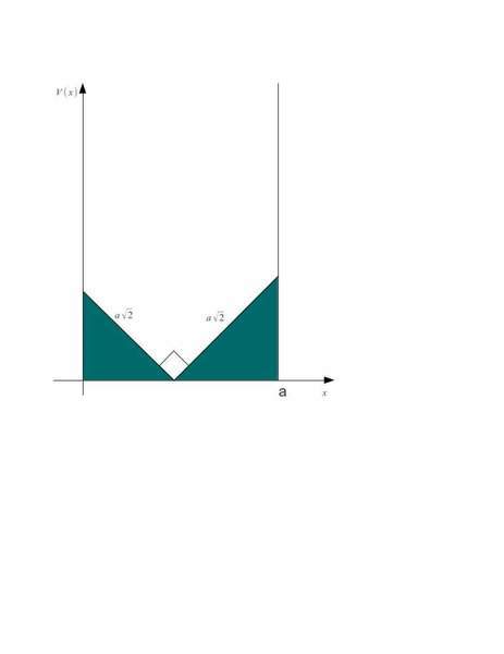

Storry, like this
That is better. What is the potential function?
ehild
That is my main problem, I don't know how to write it, I know that potential is zero inside and ∞ outside, that green area is unreachable for the particle.
