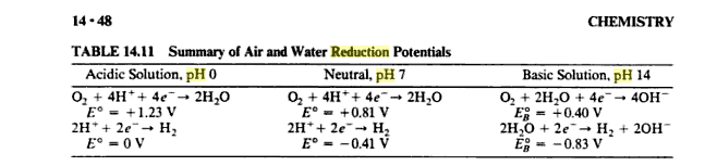

Why is it that the reduction of oxygen is more favored in acidic solution rather than in basic solution?
Acids are proton donors.
Does this have anything to do with the fact that the reduction of oxygen is in part a protonation reaction? In other words, what I'm seeing is simply that protonation is more favored in acidic media than in basic media?

Exactly.
Another (but equivalent) explanation will take Nernst equation into account. Just like kinetics depends on the concentration of species, potential is a function of concentrations as well.

Sweet. Regarding the Nernst equation and how it predicts potential to decrease with increases in pH:
Is the protonation of oxygen dependent on kinetic or thermodynamic factors? I'm guessing thermodynamic factors because in more basic medium, the thermodynamic potential for protonation decreases - i.e. the species in basic media are weaker acids than hydronium ion. In strongly basic solution the most viable acid is water, and that's not a particularly strong acid.
Could kinetic factors also play a role?
Nernst equation is about thermodynamic - it assumes equilibrium situation and fast reaction (which is more or less equivalent of doing the measurements with infinitely low current). When the reaction is slow observed potentials will vary from those predicted by the Nernst equation. That's where overpotentials come in - we have to increase the potential to speed up the reaction. That's why you will observe chlorine evolving from the solution of chlorides, even if potentials suggest oxygen should evolve first - oxygen is just pretty lazy and never reacts fast on electrodes :wink:
Cool. So why does the potential decrease relative to the standard hydrogen electrode as the pH goes up for the oxidation of hydrogen protons? I'm guessing that it's easier taking hydrogen from hydronium ion in acidic solution than it is taking hydrogen from water in basic solution, since hydronium ion is less stable than water?

So if I'm understanding you correctly the reduction of H+ in water solution to hydrogen gas is dependent on the availability of protons. It is easier to take a positive charge from a positively charged molecule rather than a positive charge from a neutral molecule, so the reduction of H+ in acidic solution is easier than the reduction of H+ in neutral solution, in which the main source of H+ will be water. And this is closely related to Ka values because Ka is a measure of the tendency of an acid to lose a proton to a base in water solution.
Yes.
