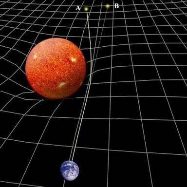

Photons are not directly affected by the gravity, but affected by the space-time curvature that the heavy objects made.
there's no force or any other direct interaction between light and the star. In the picture as you can see star bends the Space-Time, creates a curvature, and light follows that curved path.
Diagram of a sun-like star curving a grid representing spacetime, with light paths from stars A and B bending toward a small blue Earth below.
  • Diagram of a sun-like star curving a grid representing spacetime, with light paths from stars A and B bending toward a small blue Earth below.
