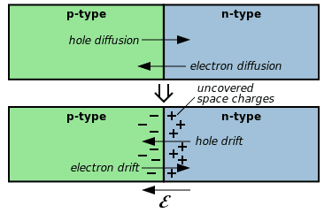

I believe the electric field in the depletion region prevents this. Electrons and holes can't move away from the depletion region once equilibrium is reached.
See the following picture. The bottom represents equilibrium.

It does happen. But each time an electron on the N-side joins with a hole, it leaves a hole behind itself. The electric field across the depletion regions causes the trillions of electrons to feel a slight force away from the P-side, as they want to follow the electric field lines. This counteracts further diffusion of electrons from the N-side to the P-side and prevents further expansion of the depletion region into each side.
Muhammad Usman said:
Because logically positive ion should attract negative electron and those ions by logic should be neutralized by why this phenomena is not happening ?
That's exactly what is happening. Electrons and holes are constantly recombining on both sides. But holes are left behind as the electrons move around, so there is always a new ion created when an electron and a hole recombine.
You are imagining a static situation a positive immobile ion on the n-side and a free mobile hole in the p-region. But the situation is chaotic and equilibrium is dynamic. The majority charge carriers along-with minority ones are moving randomly in all possible directions. I a pure p region and also in a pure n region these moving charge carriers do meet and destroy each other creating neutral sights and positively charged sites which are mobile and electrons but there is symmetry so there is no directional steady electric field. This symmetry is broken when a p-n junction is formed. Because of preferential recombination occurring in the junction region n side becomes positive and p side becomes negative and an electric field is created in the direction N to P and the junction region is depleted of both hole and electron on the average and this equlibrium is dynamic and not static.

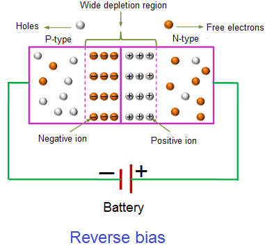

Lets take a picture below as a reference for the reverse biasing
the Free electrons are now attracted towards positive terminal of the battery and holes towards the negative terminal of the battery (Actually this process is injection of electrons in the diode). The number of free electrons are technically reduced on N-Side and so does the holes in P-Side. Now what I don't understand how does the deplition region returns back to its normal position when it now have access positive ions (Less electrons) on the N-Side (Lets focus on N-side only first)
When you disconnect the battery, charges are internally redistributed between the positively and negatively charged depletion regions until the original equilibrium state (constant Fermi level throughout the pn-junction) is established again.
Likes Muhammad Usman
Once the external voltage is removed electrons in the P-side simply flow back to the N-side until equilibrium is reached.
