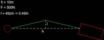

The car is stuck and the driver is trying to pull it, by pulling the rope in the center.
I need to know with what force is the rope working on the car ?
2.
F1^2 = (h/2)^2 + l^2
3.
I pretty much failed
sorry for my bad english.
Please, I need this answer ASAP
Draw a free body diagram for the apex of the rope.
