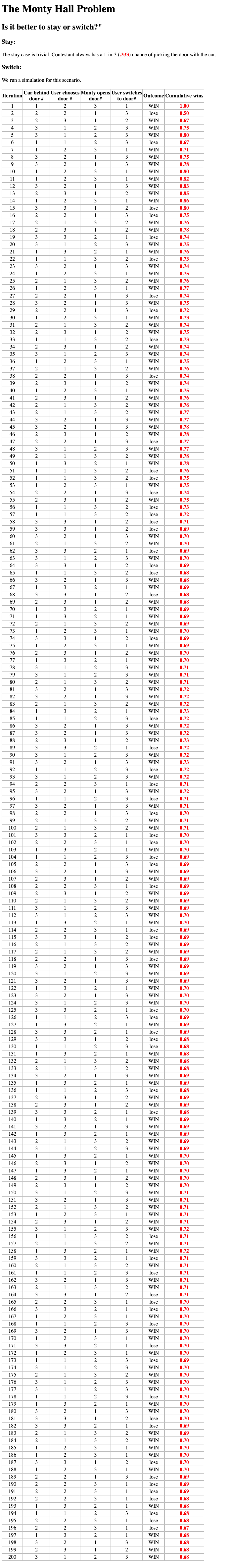

I wrote this sim. https://www.davesbrain.ca/science/monty-hall.html
Staying wins one third of the time.
Switching wins two-thirds of the time.
Empirical proof.
It also has the side effect of proving that Monty revealing the second door definitely does provide new information.

Here are the results of the 200 game sim.
You are welcome to run analysis on the randomly generated numbers to assure yourself they're not fixed.
You can clearly see the wins converging on .67.
The fact that the player does win much more after switching than he wins without switching shows that the player is demonstrably using his gained knowledge to his advantage. This is irrefutable.
So, it's demonstrable that your logic and conclusions are flawed, the only question remaining for you to figure out is where the flaw is.
Click here for 100% image.
