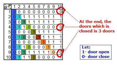

Let consider for 10 doors and 10 persons. That is the list. Now can you understand my question? Making a list isn't easy, but there is mathematical solution to this answer. The number for the closed door is 3. That is sqrt(10)=3.162=approx=3. Why?
Well now with the explanations provided by nugae and drpizza, you can see you were really on a hunch, because since its the number of perfect squares, we take the square root, and trancate it at the start of its decimal expansion, or more concisely, we take apply the floor function to it.
