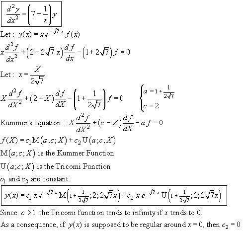

Hello !
This ODE can be analytically solved. The closed form for the general solutions involves the Kummer function and the Tricomi function ( i.e. the confluent hypergeometric functions)

Hello crawf_777
The analytical solution is :
