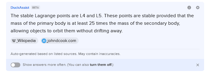

According to this, Only Lagrange points L4 and L5 can offer stable orbits, and then only for objects 1/25th the mass of the main planet or less.
Note: This is the first time I have noticed a DuckAssist AI(?) answer. It seemed very helpful.
So, Jupiter could keep two Uranus' in his harem - one at each L.

I am ignorant on this subject, but there might be a dependency between objects at L4 and L5 which disturbs their orbits. It might only work for one at a time. I'm afraid that I have already gotten out of my lane and should leave this for others.

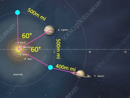

I doubt it. They're 120 degrees - a billion miles - apart. That's bigger than the entire inner solar system's diameter.
Saturn and Mars are each less than half that distance.

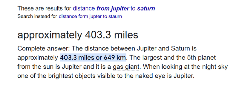

Sorry. I got my numbers wrong. Google has helpfully corrected me.

Their answer is only out by one tenth of a crore.
That is 6 orders of magnitude to a human;
or 20 orders of magnitude to a computer.
When talking about mass ratios for L4/L5 stability note that the masses involved are the primary and the secondary, not the third "test" particle. So for the Sun/Jupiter system L4 and L5 is considered stable for a test particle. If the third object has mass comparable with the secondary a different (likely numerical) analysis is probably needed to establish stability. I seem to recall there are several "constructed" configurations of multiple massive objects around a primary that can be shown to have periodic trajectories, e.g. like the Klemperer rosette, but if one want to only considered "natural occurring" co-orbiting configurations I would would expect most of those configurations to be very unlikely as any configuration also has to fit into models of solar system formation.
I would suspect that when the mass of the Trojan is such that its potential is anywhere near the depth of the L4/L5 potential well then you need to do some proper analysis. That's just a guess, though - Spivak's book (referenced in @FactChecker's link in #5) might shed more light.
