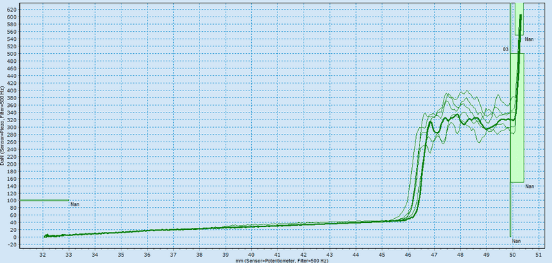

At this moment i use a kind of bushing which give me a curve like this :
As we can see I have between 46 and 47mm my effort reaching a constant value of effort for the 3mm of fitting that I have and when it reach the end there is the vertical curve. Until there it's alright

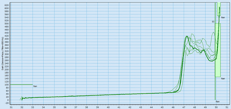

I changed my supplier for my bearing and now I've curves like this
That is to say way more versatility and rather than it remains constant between 47 and 50mm I've a lot of variations and most of time a loss of effort

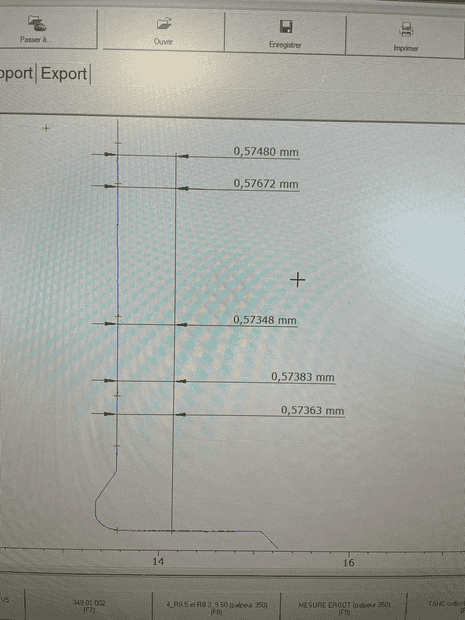

I put my bushing in a 3d machine metrology
I looked at the CCPU details
Also the inside diameter

Hello thank you for your answer, clearly between 46.5 and 47.1mm it's this but the main point remains the loss of effort that exists in some cases and not others.

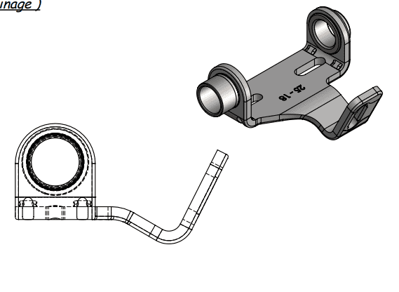

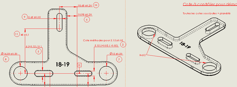

I give you some more details, my shaft is the 15 mm diameter hole in this following part (because the one of 14.5mm is for a smaller bushing
Later this part is transformed like this and the bearing which doesn't work is the big one

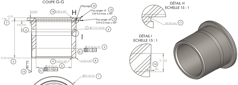

The size of the bushing is the following one

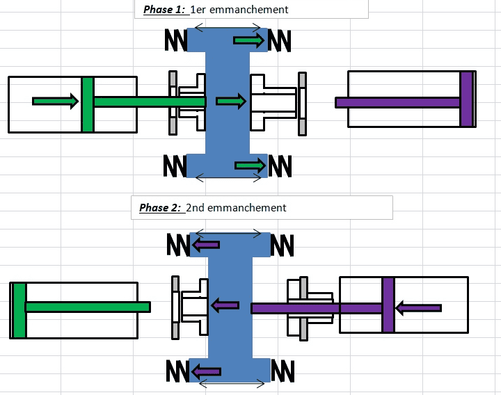

The bushings are mounted with this method :

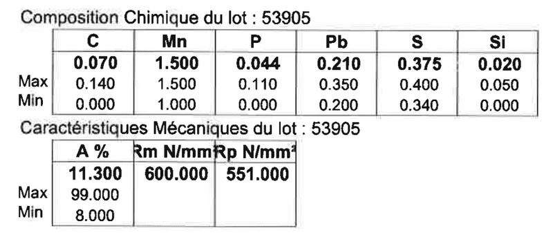

My material is the following one :
So as we can see the loss of effort is strange while for other bushings it doesn't loss effort

The bushing is opening the hole from 17.35±0.1 mm to 17.57±0.02 mm.
There is the 4° taper over 1.5 mm shown. That change in diameter is 0.21 mm.
Since 17.35 + 0.21 = 17.56 mm, we can assume that the main part of the bushing is parallel. But we see the force increasing gently, so it may be a long taper.
There is no specification if the bushing is cylindrical or has a taper for the last 4.5 mm of movement. The earlier bushings might have been tapered, while the new ones are parallel, or possibly negative tapered over the last 4.5 mm. That would explain why the final force might fall.
As you can see the profile of my bushing is perfectly cylindrical. until 0.001mm almost
So it would be another issue :rolleyes:

Your detail 11, Radius 0.2 mm;
That provides a high point which will cause a reduction in pressure beginning over only the last 0.4 mm of the assembly.
What is the thickness of the plate where it has the 15.0±0.5 mm hole?
I think that is the clue to where and how the bushing distorts during assembly.
