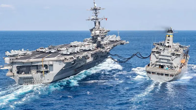

256bits said:
Large ships are weird.
... and risky ...
Aircraft carrier and supply ship sailing side by side at sea while connected by hoses for underway replenishment, with fighter jets parked on the carrier's flight deck.
While working on the helm system for the Ford, I was informed that the reliability of the steering system was most critical during underway replenishment operations. During that time, the aircraft carrier and the supply ship run parallel to each other, precisely matching speed and direction. From the wiki article:
Alongside connected replenishment is a risky operation, as two or three ships running side by side at speed must hold to precisely the same course and speed for a long period of time. Moreover, the hydrodynamics of two ships running close together cause a suction between them. A slight steering error on the part of one of the ships could cause a collision, or part the transfer lines and fuel hoses. At a speed of 12 knots, a 1-degree variation in heading will produce a lateral speed of around 20 feet per minute. For this reason, experienced and qualified helmsmen are required during the replenishment, and the crew on the bridge must give their undivided attention to the ship's course and speed. The risk is increased when a replenishment ship is servicing two ships at once.
That last statement does not apply to US Navy carriers - since they can only be supplied this way on their starboard side.
Virtually every time a pilot transfers to or from a ship approaching or leaving a harbour they have the same problem. But this is every day and in nearly all weathers. Many times there's no more than a rope ladder available on the larger vessel. It relies on the helm of the pilot boat having vast skill and on the pilot having nerves of steel. Both vessels are going up and down several metres and the pilot has to judge just when to 'step' across. The gap needs to be less than a metre for a couple of seconds.
Ive seen this many times (from shore) and it's always a relief for everyone when the pilot boat steams away. While the big ship is not fully under way they have to be moving fast enough to rely on steerage.
