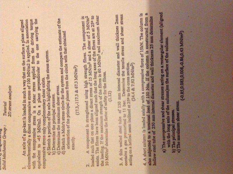

HI everybody
I am in dire need of help. I have started a mechanical systems module as part of a distance learning foundation degree. The notes seem quite sparse to me and I can't seem to get to grips with it from the start. I have attached a photo of the tutorial questions but the are no workings to help me along can anyone give me some pointers. This is not an assignment it is just practice questions.
Any help would be appreciated.

I'm having trouble understanding what you are asking. Let's work a specific problem and see how it plays out. But the photo you sent is unreadable(by me), so please type out the question. Thanks.

ah sorry I didn't know it was unreadable. here goes.
An axle of a go kart is loaded in such a way that on a surface plane aligned circumferentially a direct compressive stress of 100MN/m2 is applied. In association with the compressive stress is a shear stress applied from the driving torque equivalent to -45MN/m2. On a plane perpendicular to the one carrying the compressive stress only complementary shear exits.
a) Sketch a portion of the axle highlighting the stress system.
b) Determine the principal stresses.
c) Determine the Maximum Stress.
d) Sketch a Mohrs stress circle for the system and compare the estimate of the orientation of the principal planes from the circle with that obtained exactly.
I have the answers which are (17.3, -117.3 & 67.3MN/m2) but I do not know how to obtain them.
Hope this helps explain.
Ah. OK. I think I understand the problem.
The axle is a cylinder, so we're going to be using a cylindrical polar coordinate system with the axis of the cylinder being the z direction.
Do you use the criterion that compressive stresses are positive, or do you use the criterion that tensile stresses are positive?
In this problem, you are looking at the state of stress at the surface of the cylinder, r = R. According to the problem description, the only non-zero components of stress at r = R are σzz, σθθ, and σ. First you look at a plane perpendicular to the axis of the cylinder (i.e., "circumferentially aligned"), and examine the normal and shear stresses on this plane at r = R. Which of the three stresses that I listed are these? What are the values of these stresses?
To be continued.
Chet
