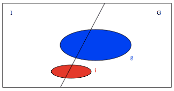

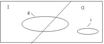

So would my Venn diagram be something like:
Well, no, there are guys who are found innocent by the serum who are actually innocent. Actually most of them. In your picture all the guys found innocent by the serum are guilty.
So I would need yet another circle denoted i over in the I subset.
EDIT: Or better yet, more concisely I think that this should cover all combinations:
So now to figure out how to apply Bayes' Rule to this mess. BR is as follows:[tex]P(B_r|A) = \frac{P(B_r)P(A|B_r)}{\sum_i P(B_i)P(A|B_i)}[/tex]

Hmmm...I still do not think that this diagram is appropriate. i think it lacks something, but i am having trouble pinpointing it.
It doesn't seem to me that Venn diagrams are terribly helpful on this kind of problem.
But yes, Br would be him being innocent and A would be the truth serum indicating his guilt.
