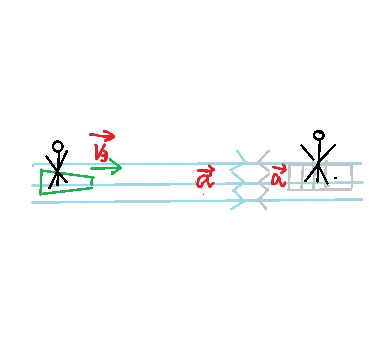

Yes. But I want to provide such example:
Let we have water, the motorboat and the boat. Water(blue) and the motorboat (grey) are non-inertial frames. The boat (green) has constant velocity ##V## (inertial frame).
Water flow moves with acceleration ##a## and motorboat moves with the same acceleration. The motorboat is at rest relative to observer on the shore (by analogy with the non-inertial still body on the surface of the Earth). But relative to the man on the boat (inertial frame) the motorboat is still. As is mentioned above, non-inertial frame move with upwards acceleration to free-falling observer. But my example show that non-inertial frame is still relative to inertial frame.
How is it possible that non-inertial body on the surface of the Earth move with upwards acceleration to free-falling observer if non-inertial body is still relative to the surface?
Where did I wrong? Thanks.
Mike_bb said:
The boat (green) has constant velocity V (inertial frame).
Just having constant V doesn't make it inertial. The boat is non-inertial because an accelerometer it carries reads an acceleration of 1 g upwards.
I assume horizontal here is meant to be analogus to vertical in the free fall case? But it doesn't match:
- An accelerometer on the motorboat will measure zero horizontal proper acceleration.
- An accelerometer on the body on the surface of the Earth doesn't measure zero vertical acceleration.
The boat is not an inertial frame since an attached accelerometer will not read 0. Nothing here is inertial, the water, motorboat, and boat are all non-inertial.
You mean that they move with a horizontal acceleration ##a## and their vertical acceleration ##g##.
The boat is not inertial, and the motorboat is not still relative to the man on the boat.
Your example is wrong in several places, including specifically the claim that the non-inertial frame is still relative to the inertial frame.
