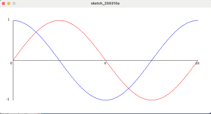

Notes:​
ChatGPT originally generated the java processing sketch incorrectly. It erroniously initialized two global integer variables width and height and used them as arguments for the size(width,height).
Its a known gotcha in processing coding. I removed the global definitions and replaced size(width, height) with size(800,400). Size() can only be called once at the start of a processing sketch.
https://processing.org/reference/size_.html
Output:​
  • A red sine wave and a blue cosine wave smoothly plotted over the interval [0, 2\pi].
  • Properly labeled x-axis and y-axis.
  • Graph is dynamically scaled to fit within the window.
