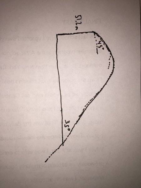

An arrow is shot at 45 degrees into the sky off of a 51.2m cliff. It lands at a 35 degree angle
I attempted to solve it using tangent of 35 is equal to the height (51.2m) divided by the distance it traveled which equals 72. I more just need to know if this is solvable given it was on a test of mine and I would like to understand how to solve it for next time.

Just wanted to know if it is solvable (my teacher gives me harder problems than the rest of the class in order to challenge me but there were mistakes in the question ie he wrote car (rest of the class had the problem as a car drives straight off the cliff horizontally, given the initial height and impact angle calculate the rest of the variables) instead of arrow and i believed he may have messed up). My teacher gave me the problem with the 45 degree takeoff point rather than a horizontal takeoff point that the rest of the class got in order to challenge me I have found out. Got full credit on the problem by solving for the horizontal takeoff point but I still want to find out how to calculate speed and time when I am only given the angle that it leaves from, angle it finishes at, and height that the initial shot is taken off of.
Hand-drawn sketch of a closed irregular shape with a straight top edge labelled 51.2 and a curved right side; a dashed line from the top corner is marked 45 degrees and another dashed line near the bottom is marked 35 degrees.
This is all that is given in the problem

Upon further review, I now think that this problem does not have a solution. Can you think of a reason why I would say that based on the projectile equations of motion?

Can you post your solution? I'd like to see how you got full credit for solving this problem that has no solution...
berkeman said:
Upon further review, I now think that this problem does not have a solution. Can you think of a reason that why I would say that based on the projectile equations of motion?
Hint -- What is non-physical about your sketch in post #8? (well, except for it being posted sideways...)

I believe it does. See the note I sent you.
Edit: after seeing a note from @kuruman , perhaps I misunderstood your reason for saying it has no solution. I had assumed you meant there was insufficient information.
As kuruman notes, you have to assume the given 35 degrees is the angle to the vertical.

After the PM exchanges, I now see that there is actually a solution (not the 35 degrees to the vertical, though). Very clever and non-intuitive. Thanks. :smile:

Draw the parabola of the flight path of the arrow. It starts off at 45 degrees above the horizontal. Find the two spots on the parabola where the arrow forms a 35 degree angle to the horizontal...
And note that the exact problem statement allows some latitude in the possible answer...

Wait, It would be physically impossible. Just realized that the arrow COULD NOT land at 35 degrees from horizontal if shot at 45 degrees vertical
Yes it can. Make the sketch that I described in my previous post.
Not if landing below the launch point certainly. But the problem as you posted it does not specify that the 35° is to the horizontal.

You should think about why your diagram shows an impossible situation. The arrow cannot land lower than the starting point but at a shallower angle from the launch angle. (That is, unless the arrow goes part way around the world, as shown in #28.)
I think Jrslager got to that in post #25.
