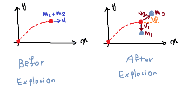

A projectile is fired at an angle of 45° with initial kinetic energy ##E_0##. At the top of its trajectory, the projectile explodes with additional energy ##E_0## into two fragments. One fragment of mass ##m_1## travels straight down. What is the velocity (magnitude and direction) of the second fragment of mass ##m_2## and the velocity of the first? What is the ratio of ##m_1/m_2## when ##m_1## is a maximum?
Conservation of energy and momentum.
I am going to use this coordinate system:

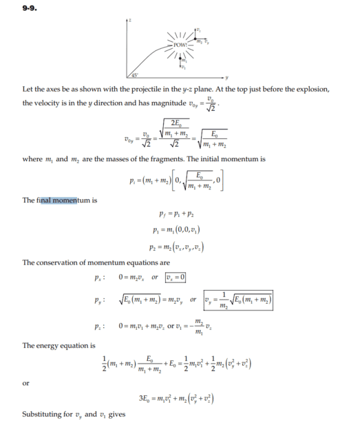

According to the answer of the book, I think no force is acting on this projectile:
Let's say at top of it's trajectory its velocity is ##u##.
Conservation of energy : $$2E_0=\frac 1 2 m_1 v_1^2+\frac 1 2 m_2 v_2^2$$
Conservation of momentum in x-direction: $$ (m_1+m_2)u = m_2v_2 \cos \theta $$
Conservation of momentum in y-direction: $$ m_2v_2 \sin \theta = m_1 v_1$$
I should find ##v_1## and ##v_2## and ##\theta##. But I failed. Are my equations wrong? Any help would be appreciated.

Why doesn’t the answer in the book mention potential due to gravity in the energy conservation formula?
And why it has written conservation of momentum for vertical direction (z-direction) when gravity exists!

I know that mechanical energy is not conserved. But I guess total energy is conserved :$$E_i+E_{explosion}=E_f$$ I just can't see why the book wrote momentum conservation in vertical direction. Because as you've mentioned gravity exist ...
Because it's not relevant. The explosion occurs so quickly that the change in gravitational potential energy is negligible.
The force exerted on the projectile fragments during the explosion is so large that the force of gravity is negligible.

In a lecture note from my university professor, I discovered an alternative way to explain this concept. Let’s consider our system as comprising the projectile and the Earth so there is no net external force acting on the object. So system's momentum is conserved. And the change in Earth’s momentum due to the explosion is negligible.
I think this is similar to what was suggested above. Anyway, both methods yield the same result.

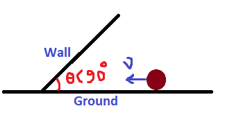

My mantra wrt idealisations is that the safe approach is to start with a realistic model then take the limit as the idealisation is approached. One case that trips people (including teachers) up is impulsive friction. Suppose a ball rolls on horizontal ground into a vertical wall and bounces back. Does friction matter?
Between ball and ground, no. Because the normal force never exceeds mg, the impulse from ground friction is at most ##\mu mg\Delta t## which vanishes as ##\Delta t\rightarrow 0##.
But between ball and wall, if the net horizontal impulse from the wall is ##p## then the vertical frictional force can be ##\mu p##, which does not vanish. It follows that the ball must become airborne if ##\mu_k>0##.
If the angle between ground and wall is acute then it gets really interesting.
Do you mean something like this?
haruspex said:
Yes
Ok. I will think more on this after my exam. Right now I can't think of a reason for :
Because the the rebound from the wall will tend to push the ball down, creating an impulse from the ground.
