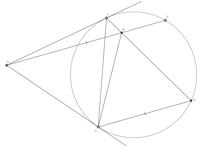

##TA## and ##TD## are tangent line of circle ##ABCD## and ##TB \parallel DC##. Show ##A,E,D,T## are cyclic quadrilateral.
I know ##x=\angle TAD= \angle TDA = \angle ACD= \angle TEA##
And ##\angle ATD=180-2x##
But I don't know how to prove ##\angle AED=x##.
Or there's another easily method?
Thanks.
Geometry diagram of a circle through points A, B, C and D, with tangents from external point T touching the circle at A and D. Chord TB is drawn parallel to chord DC, and AC meets TB at E.
I've just known that ##\angle TEA = \angle TDA## prove ##AEDT## are cyclic.
The problem is solved. Thanks.
